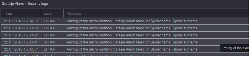

Hello boys.
I have set up an alarm system that will generate status after my current location and it kinda works, it can not turn on / off alarms. When arming / disarming the alarm it seems like it miss the username and password. how did you solve that ?
I´ve got the same problem and opened a ticket for that. Seems as if only arming is concerned. Disarming works if executed by a rule. I´m going to try it with "fast arming" tomorrow but I think if executed by a rule it should work even without fast arming. The missing username (first and last name) is a known problem and at least with 1.0.17 it worked nevertheless. Think thats a problem with 1.0.19
Hi Jonas,
I just tried it out: With "fast arming" selected (hope the translation is correct, in German it is "Schnelle Scharfschaltung" the rule can activate and deactivate the alarm. The username is still missing in case of arming the system while it is there when disarming. But nevertheless it works, even without the name.
Hello Klaus G.
You my man is the hero here :) it worked with Quick arm, i didnt have it enabled thank you
;-) I think its a bug in the firmware. Quick arming makes it possible to arm/disarm a partion by using a simple switch without username (so you don´t know who turned the alarm on or off) If it´s activated by a rule it should work without quick arming because it´s done by the system. It already works with disarming so arming should work too. But up to now we have to use quick arming when switching the alarm on by a rule. I´ve opend a ticket so I´m sure they will fix it with one of the next updates.
