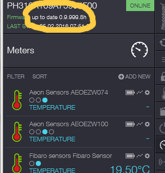

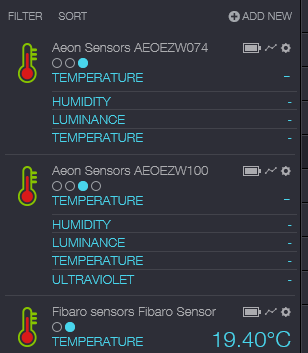

I have both AEOEZW100 and AEOEZW074 successfully included but I cannot see any value. I even waited one day, but still no values. What's that? firmware up to date 0.9.999.8h
q is the latest version not h.
aha, this is a very plausible reason why it not works :-)
