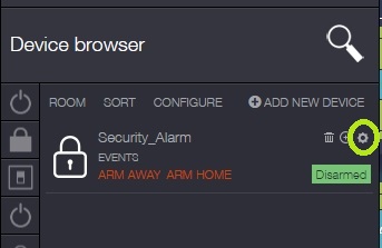

1. Go to Alarm on Device Browser
2. Go to settings (gearbox icon)

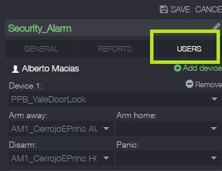

3. Click on "Users" Tab

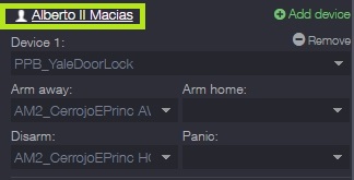

4. Click on the name of the user (other than the master).

I've found the menu (thanks) but the issue is not resolved. Still think I'm missing something obvious.
Added all the user rights by following this tutorial. https://community.zipato.com/knowledge-base/article/administrate-member-security-privilege_1 basically the same as mentioned by Alberto above.
However my new user cannot arm or disarm from the Zipatile (it works from the control center webUI)
