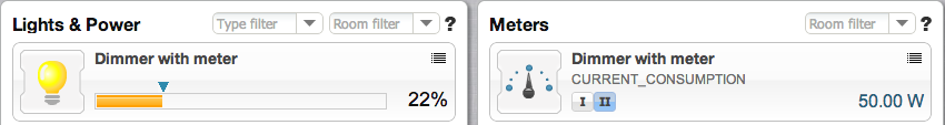

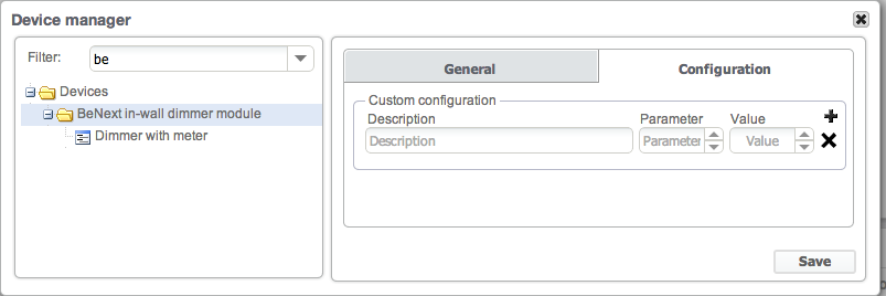

I've tested it with a Zipabox. It's supported, recognized as "BeNext in-wall dimmer module", allows ON/OFF/dimming. But parameters are not integrated yet and energy reporting is stucked on 50W.

I have the same issue as Damien@Domotique-Store.fr (Energy always equal to 50 W)
Will Zipato correct this issue ?
This issue has been corrected by Zipato (with our help). The device works fine now on Zipabox.
