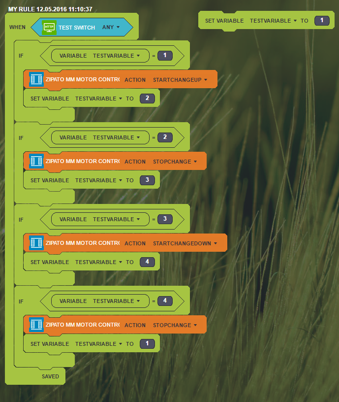

Hi Jacob,
would a rule like this do the trick. let me know if it works. Note that you will have to set the variable to a value on first use. So either insert the first set variable puzzle above the first if block, run once remove it, or just create another rule to set the variable then delete it.

Tested it but the blind only move a few cm then stop.

Hey Jacob, this might be because you have a momentary switch. Did you try it with "when switch on" instead of "any"

or try a when block first with "any" state, then an if block with "on" state, then the rest of the rule

Don't getting closer....
Sometimes the variable get sent and sometimes not.
No luck hear!

The thing is with this two simple rules it works perfect and never miss a input. Not once. But with variabels the button seam to miss the input?
