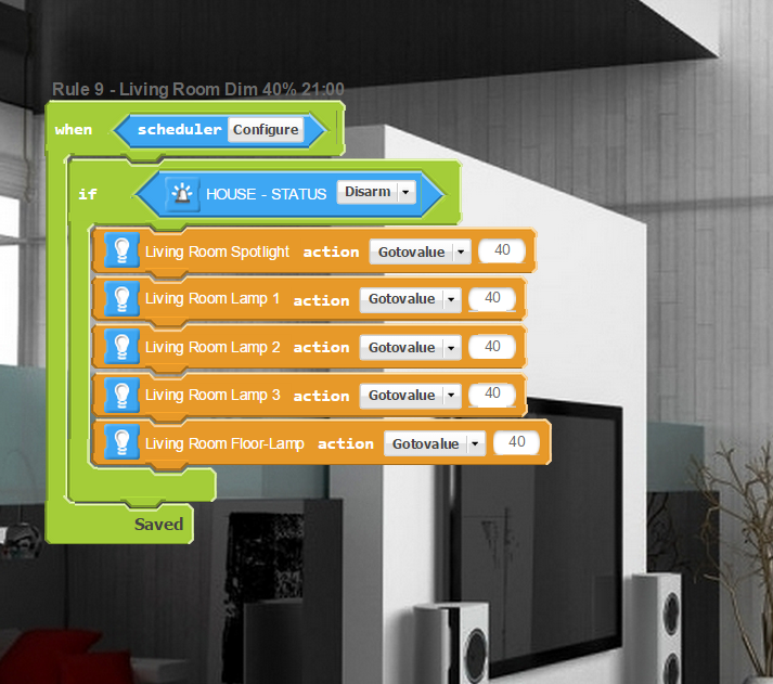

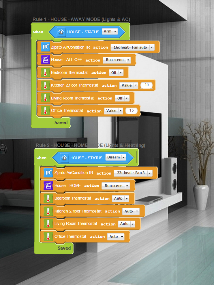

I used alarm device to control home and away settings.
Also i have this included in all rules that i dont want to run if i am not home.
See pictures...
