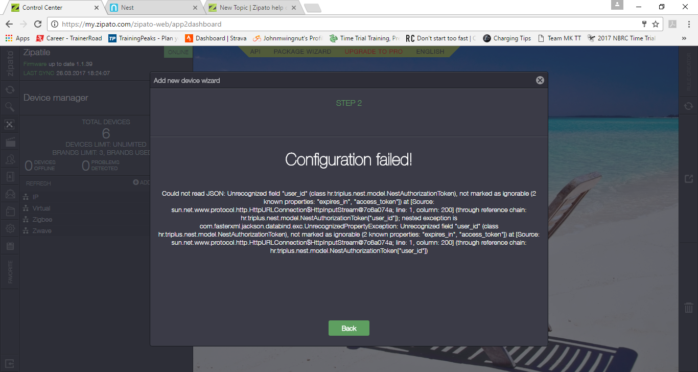

I go to add device and then select nest as the network. I follow the link and get the PIN code, but every time I enter the PIN code into the Control centre its comes up with a long winded error message which I have attached to this post.
Can anyone advise what I am doing wrong?

I had that once................ I just deleted the nest, added it again, generate new pin and then it worked.
