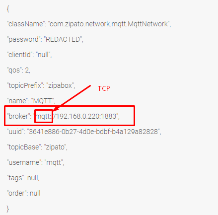

This is my config:
"className": "com.zipato.network.mqtt.MqttNetwork",
"password": null,
"clientId": null,
"qos": 2,
"topicPrefix": null,
"name": "MQTT-zipabox",
"broker": "tcp://192.168.1.70:1883",
"uuid": "** UUID of mqtt network **",
"topicBase": null,
"username": null,
"tags": null,
"order": null

For me it's working with mosquitto_pub -t "zipatozipabox/request/attributes/UUID/value" -m '{"value":true}'
my config is
"clientId": null,
"qos": 2,
"topicPrefix": "zipabox",
"name": "MQTT",
"topicBase": "zipato"
Yes, thank you Olivier, that is working for me too.

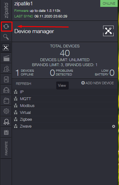

Hi quizzical.
After each change of settings (via api too) you need to synchronize the device.
/143bef7b3c4365d52bedd36747c68a3d
/4fc9885fdc22a46cb19195f55a93c8cf
Hope this helps. Be careful ;-)
