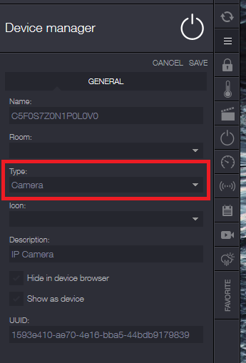

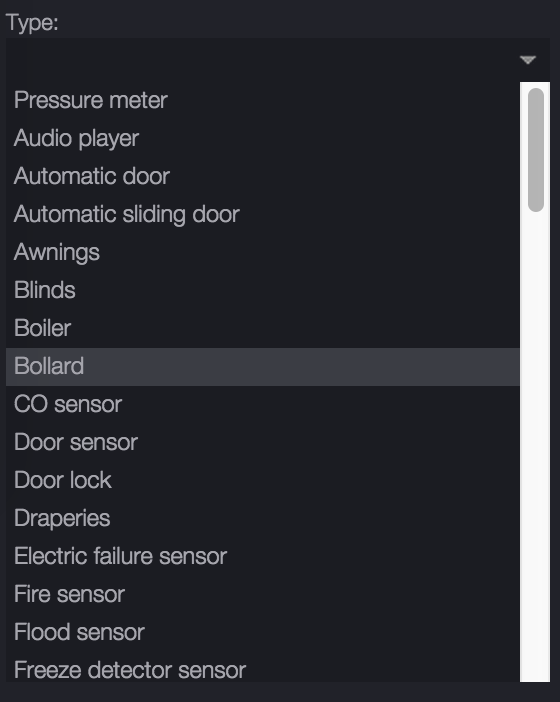

I not able to see the type Camera on my zipato, on the Device Manager I search the camera and when I edit it there is no Camera type option.
I have the same problem as David, "Camera" type is not present. I have a D-Link DCS_2330L. Support for that camera would be appreciated. I would like to stay away from BETA firmware if possible.
