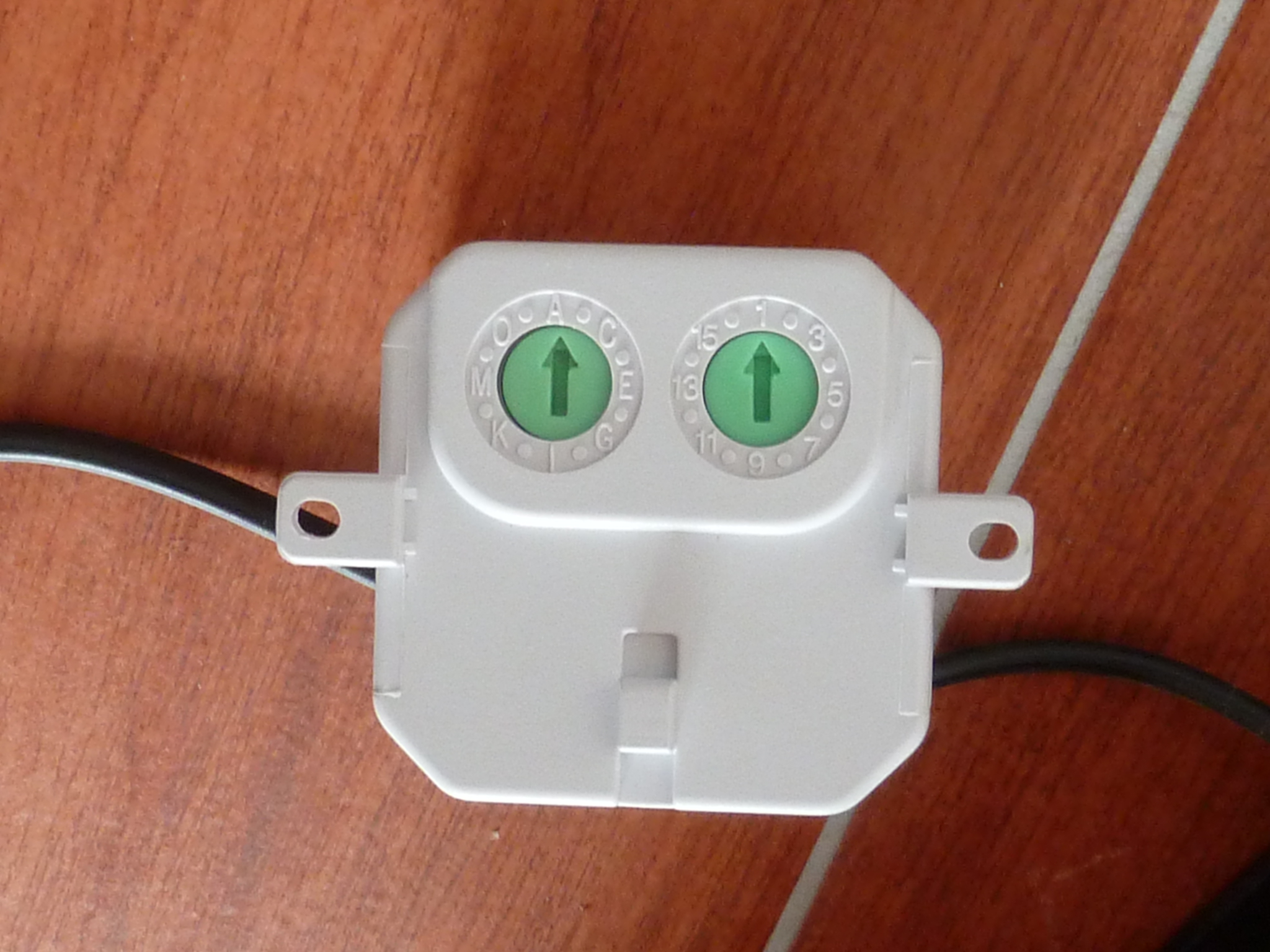

Thanks for your reply, i've tried 2 new CMR300 and near the zipabox but the probleme is the same.
My CMR300 have got 2 wheel code (1 for home installation A-P and 1 for device 1-16), i tried many different configuration but not work.

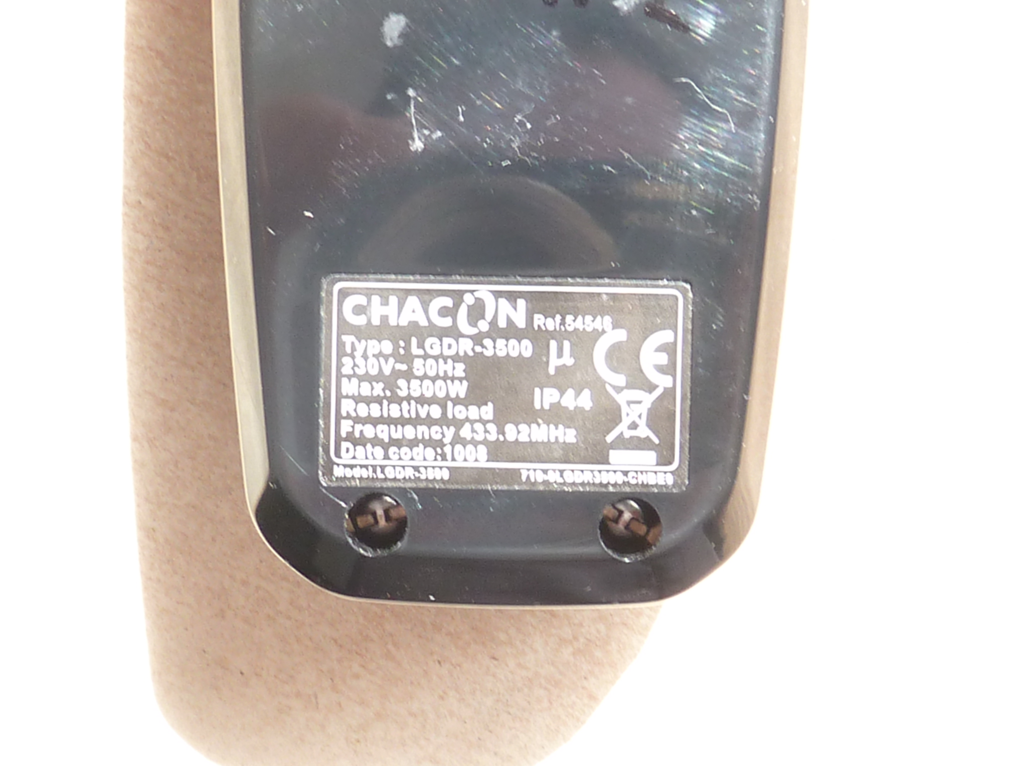

I try to add an other chacon device (plug CAYCR-3500 for you but LGDR-3500 for me) and it works great.
I send you picture of them.

Hi Karlito,
OK, I see what the problem is. We support LCMR-300, which uses a different protocol then CMR-300 (LCMR has no code wheel and uses CoCo protocol). We will add it, but please create a new ticket at support.zipato.com and name it CMR-300 support, so we can track this issue.
