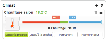

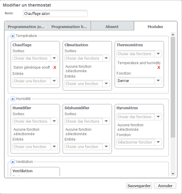

I installed a "climat control" for my living room. I want to activate a module ON / OFF according to the temperature detected by my temperature sensor.
I think I have correctly set my Zipabox but the module ON / OFF does not react. Attached some screenshots.

I have the same problem. I created a thermostat and it does not switch on or off the fgs211. The thermostat does display 0°C. The temperature of the st814 is available on the zipabox thermometer.
Thermostat doesn't work until it gets the temperature info. Once it gets temperature value, it will start switching fgs211...
