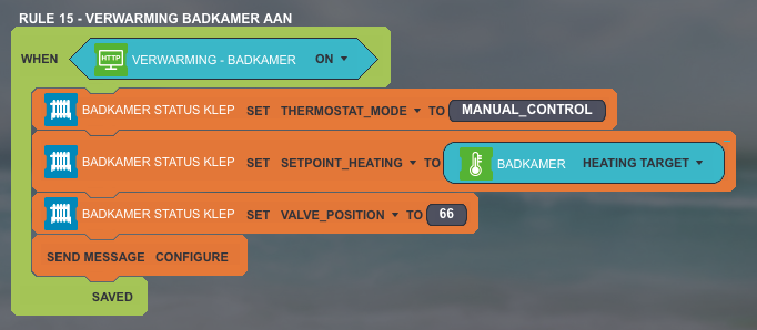

The thermostat value HEATING STATE can't be used in rules.
To use the heatings status I created a virtual switch. This switch is set as output device in the thermostat.
The virtual switch status changes when the thermostat start heating. The virtual switch can be used in rules as trigger.
