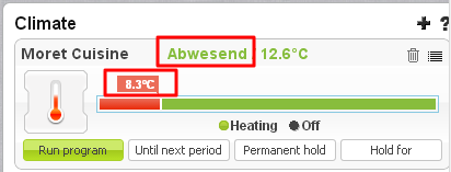

I've put the widget on "absence" with a temperature of 8,3C (see image 306).

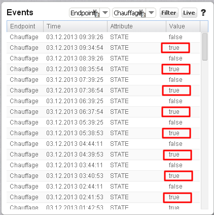

But in the events I see that the heating (chauffage) is opened regularly, even if the real temperature (12,6C) is far above the requested (8,3C). see image 307 with the events of the heating switch. Why do the switch doeas not stay closed (flase) till the temperature of 8,3C?
Why do the Zipabox continue to heat, if I want to reduce the temperature?

I will try to find out, who is regulary triggering the true from the heating. Is there a way to do this, following the track from an actuator back to the rules?

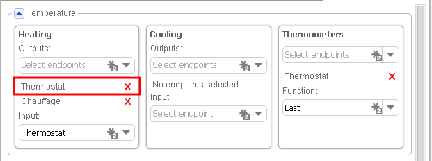

seems that i had to add the thermostat to the heating outputs.
Without something influences the rule evers 59minutes.
Now it is OK, but I do not know why.
