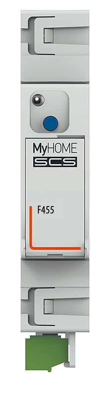

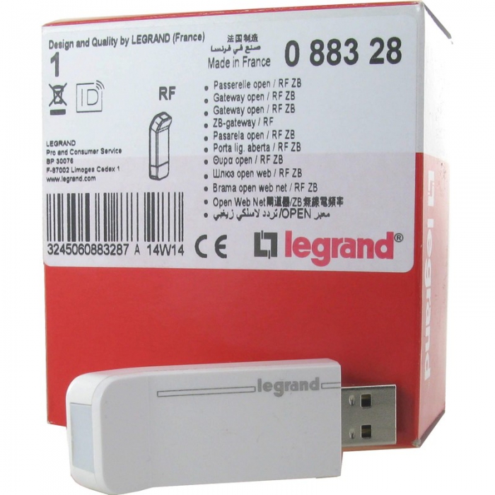

@Sebastian Popovic:
It is true that Legrand/Bticino uses a private protocol known as "MyHome" --actually two protocols, one wired called "MyHome Bus" (BUS/SCS) and the other wireless called "MyHome Play" (Radio/ZigBee). On the latter, they indeed use a proprietary implementation of ZigBee.
But both can interact with other home automation systems through IP with the protocol OpenWebNet, which exists since 15 years:
http://en.wikipedia.org/wiki/OpenWebNet
(please follow the various links at the bottom of the wikipedia page)
For example, MyHome BUS can talk through the OpenWebNet protocol with the appropriate wired gateway (Bticino F455); while MyHome Play can do the same wirelessly with the USB gateway dongle connected to a Windows or Linux box (Legrand 088328 or Bticino BTI-3578).
MyOmBox managed to make a Raspbberry Pi system using OpenWebNet perfectly. Sadly they only propose to control Legrand switches. Your Zipabox is so much better with its modular components and extensibility!
So please reconsider making a compatibility layer for OpenWebNet using the gateways I linked to, which would open the way for Zipato to the very large market using Legrand/Bticino/Arnould solutions.
