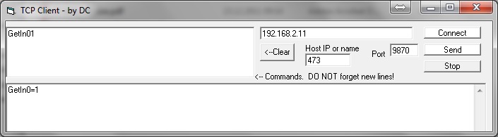

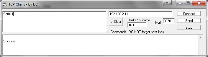

I try to connect my IPX800 to my Zipabox. I want to use the command "request socket" for sending the command << TCP>> <<IP>> <<port>> <<command>>. but is not functioning! I tried directly from an other TCP client and is ok! Somebody as an idea?
I want also try to read the input from IPX but i have not the necessary space to put the link (Zipato link for virtual meter) is too long? it is possible to read the status by using request socket from Zipato? from other program is ok?
