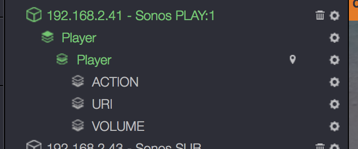

I'm able to successfully link my Sonos Play:1 to Zipato.
(without setting the Sonos system in inclusion mode though - it automatically finds it when I select to add a Sonos device)
After that it does show up as 'Audio Player' in the device browser.
However, any action I choose (e.g. stop, pause, volume increase/decrease) doesn't cause any state change on the Sonos system when listening to internet radio station.
Should it? Or does it only work with e.g. playing MP3 files or URLs set by Zipato rules?

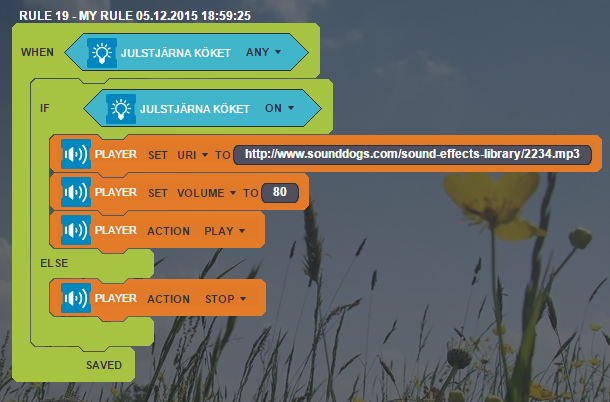

Sure, you can do that. Look at the example rule. When even i put on the christmas lights in my kitchen window it plays a little tune :)

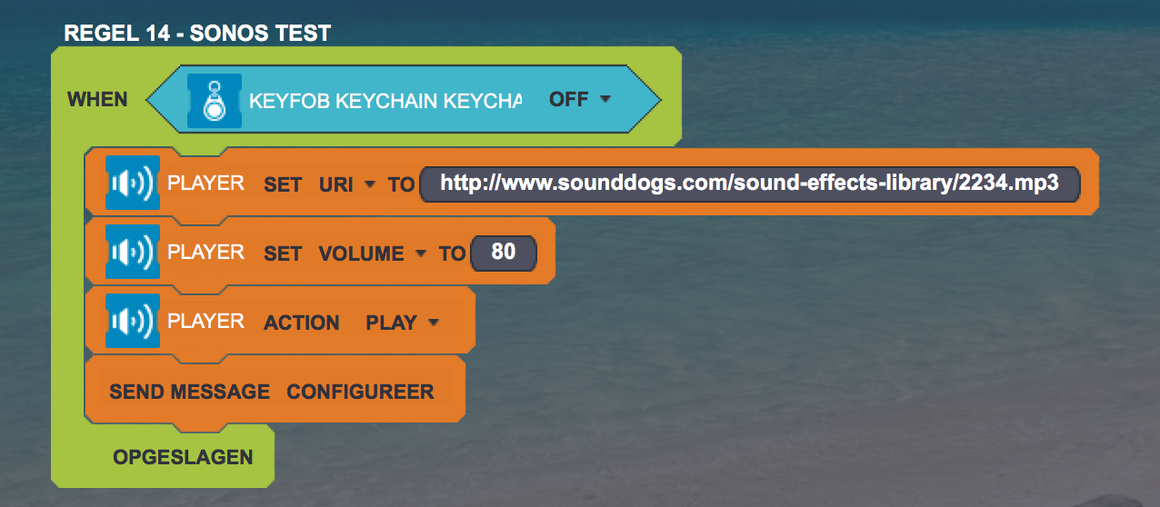

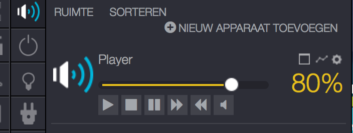

Thanks for the reply!
I've copied your rule and clearly there must be something wrong on my end :-/
To test if the rule is indeed executed I've added a push notification which is actually sent.
Also the volume shows as being set, yet no sound at all..
No big deal so I'll wait for next firmware update and see if that might solve the issue
Open the Sonos program on your desktop PC. Have the program side by side when you execute the rule. If the mp3 has a samplerate or or encoded in a way that sonos does not play, you will get a message in the desktop sonos program saying why the file is not played. Meaning, that sonos will not play every type of .mp3 file you throw its way.
EDIT:
I see you tried with the file i had in the rule i posted. I just google searched for mp3 files to show that, i did not want to post a rule with files i host myself :)

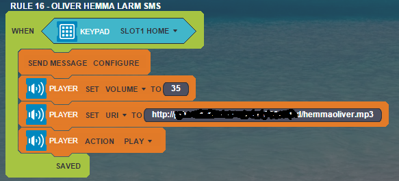

You can use this site to generate mp3 files thrugh google speech, inc. swedish, http://soundoftext.com. I use that so my Sonos says things like. The alarm is now armed. Or, Welcome home "name of the person whos rfid tag disarmed the alarm", the alarm has now been disarmed.
You can also use it as a siren, with any sound you want. If my alarm is tripped the Sonos plays a mp3 that was created with google text to speech that says. The alarm is now on, the owner has been notified, and pictures form the cameras have been sent. The sirens will go off in 10 sec.

How do you pick up the user from RFID. Are you not using the Zipato RFID mini keypad?
I just saw your rule.I was not aware of the "slot1 home" possibility.
Yeah, thats how its done. specific slot to specific user that triggers the welcome message to greet the user asigned to that slot

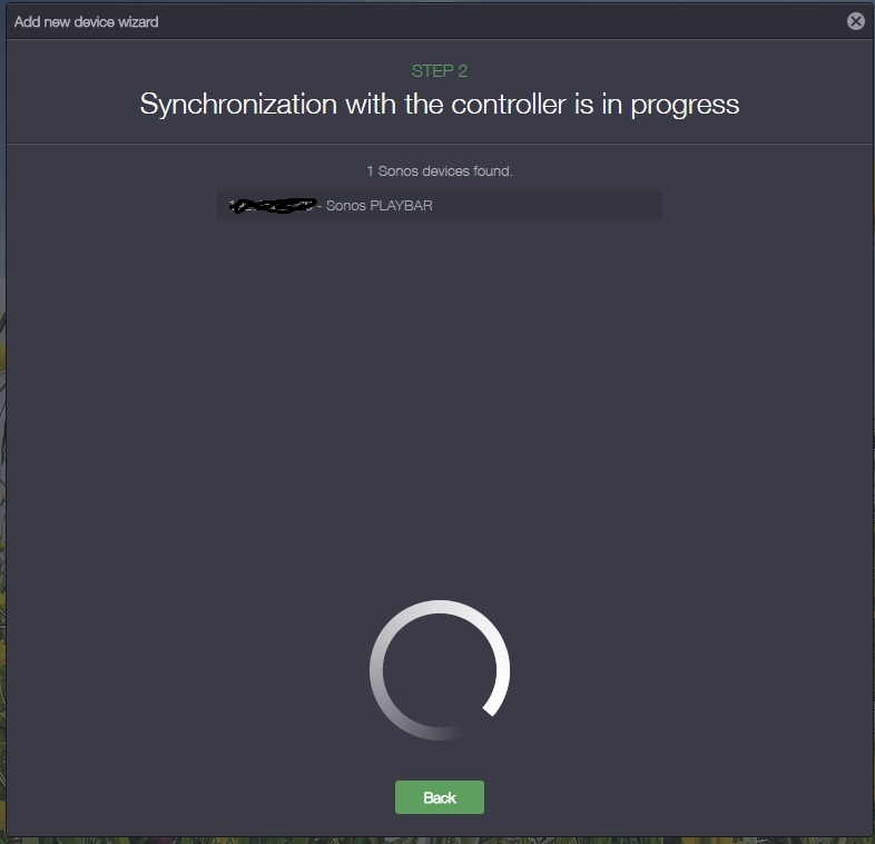

I hope they add support for sonos bar, I have one but cannot use it with zipato...
Dear Alberto,
The Sonos bar is not currently supported, but our team will certainly provide support for this device in the near future.
Pero Zovkic

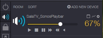

Woo Hoo!! Play bar is also now supported!! See attached.
