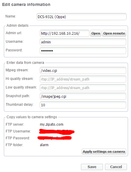

I used the "old version" UI to add my dLink dcs-923l
Enter url: http://192.168.1.xxx or what ever your dlink camera IP is.
Enter username and password you use to logon to the camera interface and use mjpeg and snapshot urls as attached.

I have a DCS-932L and it does NOT support the rtsp (real time streaming protocol) that is used by the "Hi quality stream" and "Low quality stream". You should therefore leave those two configuration items blank
In order to get those two options working you will need:
a) A Web Cam that supports rtsp (i.e. NOT the DCS-932L)
b) A rtsp plug in in the browser you are using (free download of VLC will add the necessary plug ins)
c) Probably (not sure on this one) a Dynamic DNS or Static IP address in order to "find" the camera
So, when using the DCS-932L, the only options you have are :
Snapshots to FTP
MPEG stream option
I got both of these working both local and remote after setting up dynamic dns in my router.
hope this helps
/Marcus
