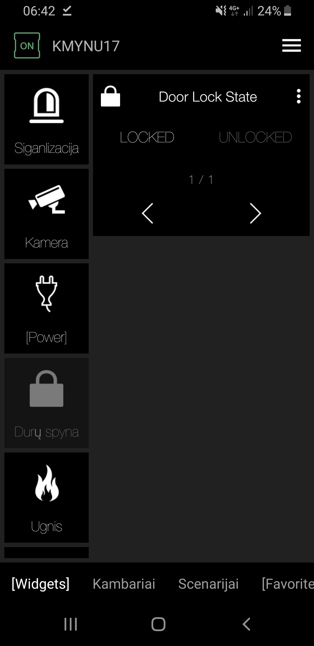

I have the Danalock v3. I have successfully included it in my zipato system.
The lock status shows up correctly in the GUI, but it seems like the rules don't get triggered by the status/state.
Any ideas?

I have also a problem with the danalock V3. Either I close the door via Rule and in the GUI I see looked but the danalock still is open or I open the danalock manual and the app don't change the status. Sometimes the danalack close via rule only after 4 or 5 attempts. The danalock is very close by the zipabox. 7m without a wall.

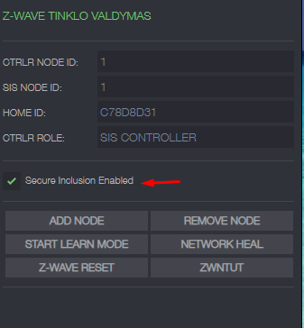

In the http://doc.eedomus.com/files/Danalock_V3_Product_manual_Z_Wave_V_0.9.1.pdf manual is states that "A security enabled Z-Wave controller must be use." Security is enabled on my controller under Settings. When I look at the Z-WAVE NODE INFORMATION for the door lock it says "SECURITY: false".
How do I change to "SECURITY: true" on the node in Zipabox?

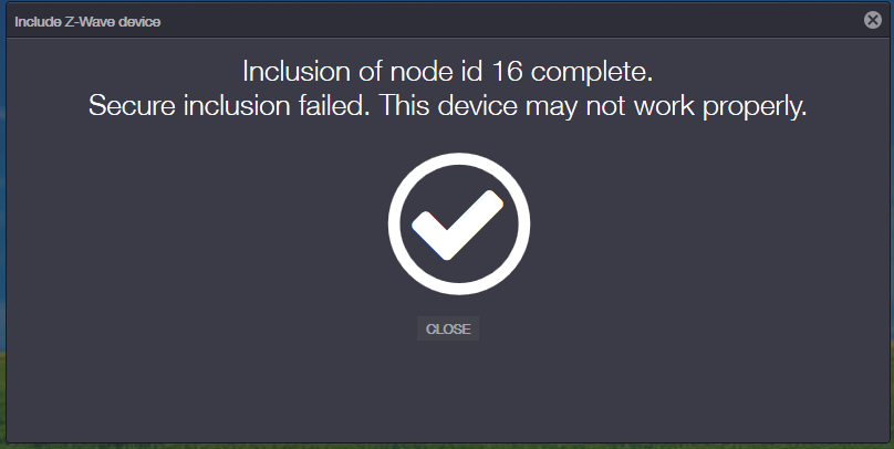

My Zipabox was approx 50 cm from the Danalock when inclusion failed.
Mybe the distance between them is required to be closer than that for the secure inclusion to work.
What was the distance between your devices?
Please restart your zipabox before you start the including. I have 3 danalocks and the distance was 2m.

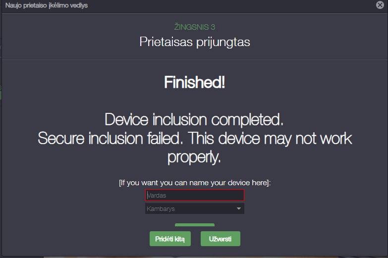

Secure inclusion fails for me too, and I'm unable to read/write lock state. Latest FW on lock and zipabox.

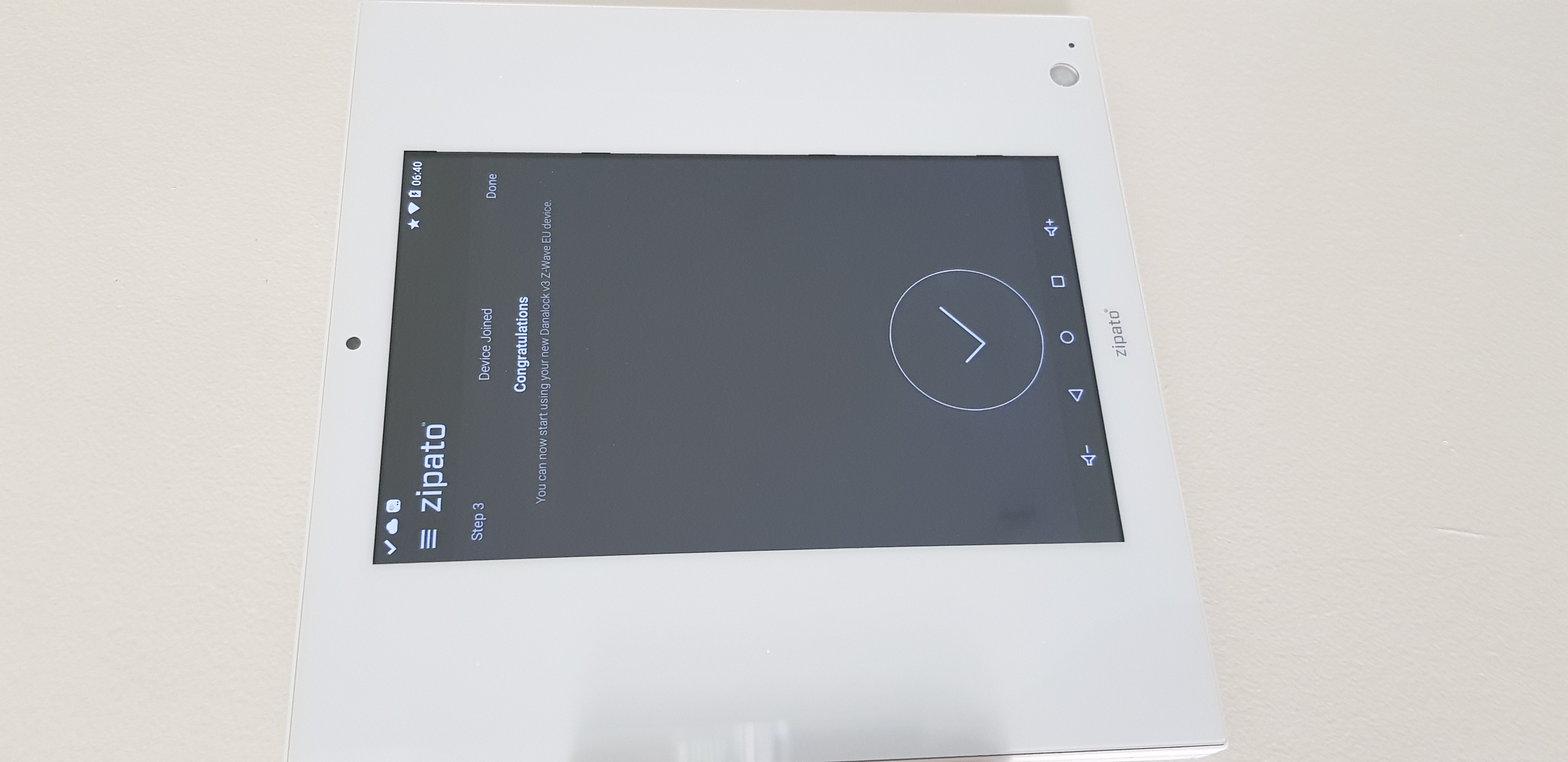

I have added this device on my Zipatile controller, but physically Danalock does not work :(

Still nothing, I have tried many times to reset Danalock, Zipatile and still have an issue with secure inclusion enable. If I enable "secure inclusion enabled " then get an error including Danalock on Zipatile if I disable "secure inclusion enabled " - then I add Danalock on Zipatile, status (lock/unlock) changes (On Zipatile, Phone etc.) but physically Danalock does not work.
On Bluetooth, Danalock works perfectly!
FIXED. Just needed to downgrade Zipatile firmware version. Danalock is working now perfect! The Next test with Yale Doorman :)
