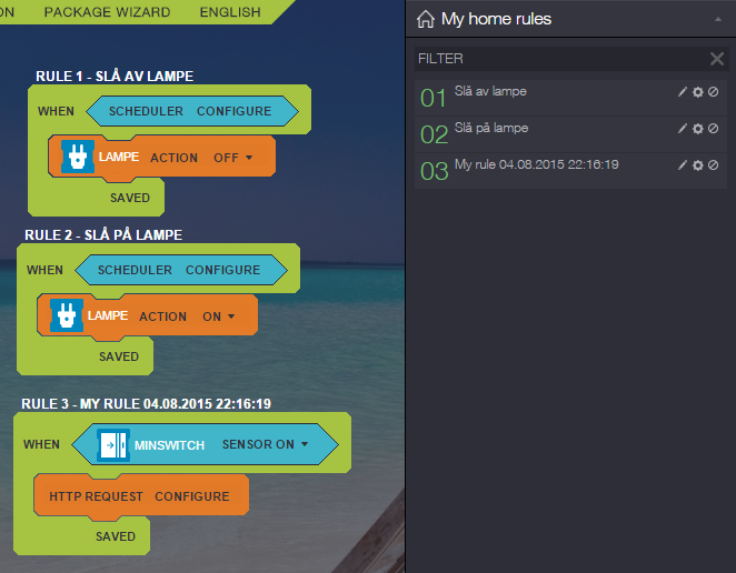

I changed a rule, removing a push message, but it still seems stuck in the system somewhere. It doesnt seem like the rule is updated with the new HTTP Request action (see rule 3 at the screenshot). The rules are synchronized correctly, and I got no errors. I have also tried to reboot the box, but still the same problems. The screenshot of all my rules are attached. It's only three simple rules with no "send message", but I still get the push message i defined previously.

Update: It doesn't seem like waiting for a period of time solved the problem. Approx 12 hours after I have synced the rules, rule nr. 3 still sends me a push message when the virtual switch is ON. The send message puzzle has been replaced with a HTTP request puzzle as shown in the screenshot.

I see now that I used non-latin charachters in my first two rule names (the norwegian char Å), maybe that caused the compiler to fail.
