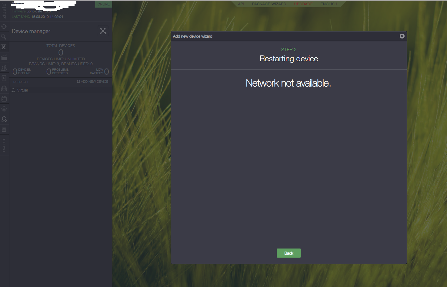

            On a completely fresh box (new from the shop, or just reset to facroty default) I have problems adding the first device. I get "Network not available" when adding a device (see screenshot). This happens with all devices. I have tried to add virtual devices, nexa and other devices.
This first happened when I bought the box, and now just after a reset to factory default 30 minutes ago.

Have the same problem after Reset Factory and It solved now.
Here what I did:
+ Upgrade to Beta Firmware
+ Switch to Old Version UI
+ Logout
+ Sign in
Don't know what happen, but for me, that's work.
Hope this help

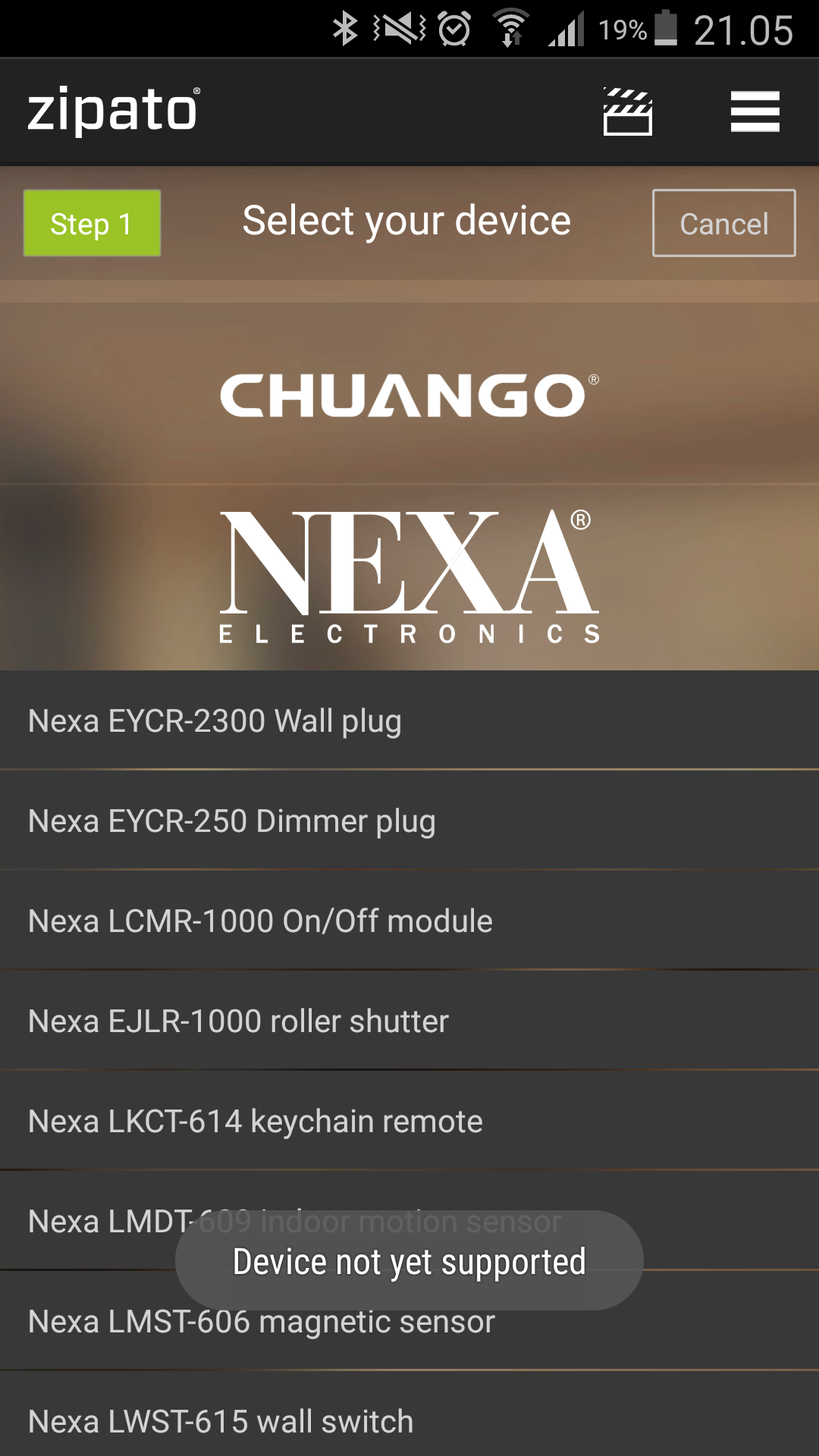

The Android app reports "Device not yet supported" on all devices I try to add. This is related to the same problem.

Hi Ngoc,
Thank you for your help! You provided me a fix before support managed to respond on my ticket :)
I switched to the old UI and managed to create the device there. After that, I could switch to the new UI and add more devices.
No need to change firmware.
Thanks!

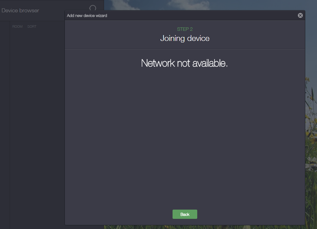

Too quick.. I can only add virtual devices, not Nexa devices. Same error. Still no response from support...

I've just added a new zipabox to my account, updated the firmware to the latest version, but have this same problem: "Network not available" when trying to add a new z-wave device.
- Synchronization with the controller doesn't work.
- Updating the firmware to the latest beta and back, didn't help
- Reset factory settings, signing in/out didn't work.
Any ideas?
