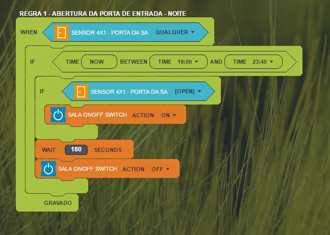

I wonder if it's possible for the rule on the left to be triggered before the virtual switch state change to "on" has fully propagated through the system. We know that virtual switch states don't get updated immediately. For example, I have some rules which are triggered by a virtual switch going to the "on" state. When the rule is triggered, I want to turn the switch back off. But I find that, in order to do this, I have to insert a wait of 2 seconds before the "off" action, otherwise the switch won't go off. In fact, I added a second "off" action at the end of the rule just to be absolutely sure. Perhaps the left-hand rule, with a 2-second wait between the "when" and the "if", might work correctly. You could also try "Refresh all", in case the rule somehow fails to receive the updated state.

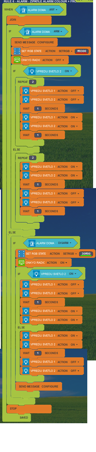

Hi everyone. I now have some more clues to this...at the beginning I thought it is only single devices that switch not linked to rules but it is way more. Let me explain in detail although it might be long story. So the bottom line it is not only devices affected but it appears that also rules...or the rules are then trigger (fully or partially) if the triggering device is triggering...
it all started with my partner reminding me to not forget to turn off the light in the night...funny, I thought I'm aging and starting to forget things...but it is not (thanks god its not me...). it seems that it was always the outside light (and it is happening now for over a week), but now I have experiences not only light but nearly (not fully) a whole rule firing without no input or triggering action.
My alarm is linked to 2pc keyfob which were in the porch. I was sitting with my partner in the living room watching TV when the zipatile beeped (the same as when alarm disarms) and my onkyo radio started to play music. This is a tipical behaviour when someone disarms the system, but noone was touching or using any app, keyfob, nothing at that moment.
I have attached my alarm rule that executes when someone arming or disarming the system. You need to follow the rule from the part when alarm is disarming - and here is my log of events:
22:03:11 - alarm disarmed (on its own, without rigger)
22:03:11 - rgb colors of the zipatile buttons changed to green
22:03:11 - my onkyo radio turned on
22:03:22 - the zipatile internal siren that is part of the alarm as a squawk device beeped (because it is a squawk device is not listed in the rules).
Now strangely none of the lights inside of the if/else puzzle did turn at all.
The above means that this random switching is more than only zwave devices. Also the virtual (and possibly all) devices are affect as in this case my virtual alarm pro disarmed without an input, however not the whole rule did execute which is even worse as shows more unreliability...:(
I really hope this will help zipato and Vedran to finally decode the message...becuse this is not acceptable for a system that is now lot of years old and still...sorry zipato, it is a flustration that talks right now.

David, the most troubling this is that the alarm is virtual. My Virtual alarm got disarmed without any trigger...and then the rule started...I was sitting in the living room with my partner and then suddently the onkyo radio turned on, changed source,....did all that it's required to do when the onkyo switch is turned on. And if you look into the rule you can see that the Onkyo and also the RGB did react to this disarm. Even my squaws did beep...but not the lights...
So no interference there. This is why I'm shocked...

Well for my case with the alarm there are in total 2 weird things:
1. that the alarm itself disarmed
2. the lights did not switch as per the rule
This makes it even more weirder.
