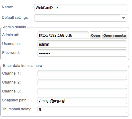

Can you help me for the configuration of my web cam, i don't know the parametters to put to get live stream

After poking around the Internet I have found these URL's for the DLink 932:
For the "Snapshot Path" field enter:
http://IPADDRESS:PORT_NUMBER/image.jpg
For the "Mjpeg Stream" field enter:
http://IPADDRESS:PORT_NUMBER/video.cgi
replace "IPADDRESS" with your camera IP address
replace "PORT_NUMBER" with your camera port number (default is 80 which you can leave out)
Unfortunately that Web cam does not support the rtsp protocol so you have to leave the fields "High Quality Stream" and "Low quality stream" as blank
Remember to transfer the FTP settings given on the Zipato widget into the camera FTP settings (just cut and paste)
Hope this helps
