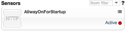

first i create a virtual sensor "alwaysonforstartup" (pic1)

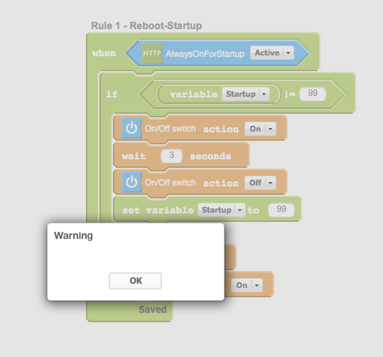

and the rule (pic2)
and nothing happen ....

and the rule (pic2)

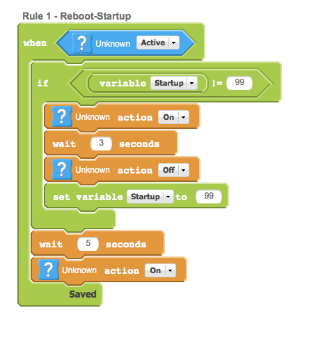

some strange think now, my rule get "?" when go back to the rules creator, and when i try to put back sensor and actuator, i get a warning"
i send request to support
