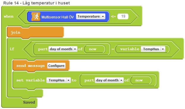

I like to get an e-mail as soon as the temperature are below 19 degree celcius in my house.
Hovever, since the Aeon labs multisensor is sending the temperature to zipabox quit freequently so would I like to have an variable to check if I have sent an e-mail today. If no send e-mail else dont send.
I made the rule like attached but it does not work and it has to do with the variables,
I dont like to make a schedual that is checking this once a day.
Thanks in advance
Lasse
Where you have IF dayofmonth(now) = Temphus
I think that needs to be IF dayofmonth(now) <> Temphus
i usually do variable first then what you wanna set. But don't think that's the problem.
But why not
When temp < 19
If NOT variable Temphus=1
end email
set var Temphus to 1
Then reset the temphus to 2 every night with a separate rule.
But why not
When temp < 19
end email
I think that the problem is that the variable Temphus is set in the IF statement.
So this variable is never initialized.
That mean that the if-statement probably always lead to false. However that exit is not programmed.
Try this:
this way you can set the time between notifications (if the condition is respected)
You also can change the notif range (once a day rather than every x hours)
Try this:
