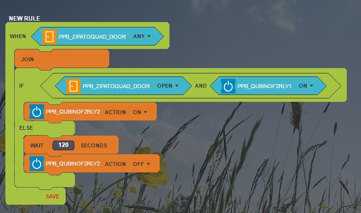

You don't need to use repeat to update sensor state, you can achieve this using the puzzle JOIN. See below and let me know if this works as you expect.
PPB_ZIPATOQUAD_DOOR = VOORDEUR
PPB_QUBINOF2RLY1 = VOORDEUR LAMP
PPB_QUBINOF2RLY2 = HAL LAMP

Alberto, your code works perfectly, thanks for the extra printscreen, really helped me out :-)
