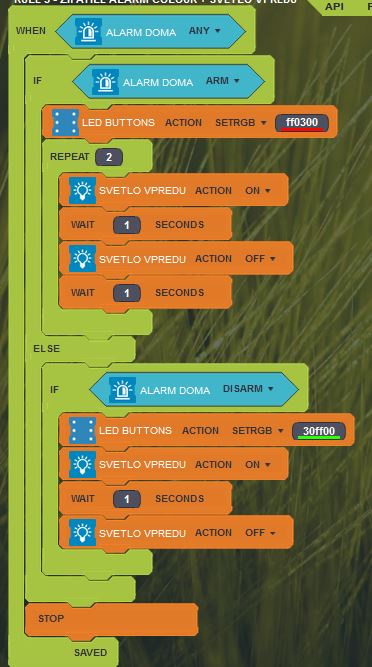

Since the alarm partition only natively supports a squawk function, I've been trying to emulate a traditional alarm panel to beep during the exit time. The following mostly works (timing delays are rough) but - If I disarm during the ARMing timeout, the STOP function does not halt the rule.
I have tried:
9cb40960f8c3df9c4c1569fe5069e4cf
As well as:
0ecf0eff551a0e0c481e938d69ec56a6
In both cases, the REPEAT block continues. STOP has no effect on it.

Hi Alberto,
Please see my rule. it seems to work fine but do you also recomment uding a join statement?
Attila,
In your case the execution of the rule seems much faster, two beeps to arm, one beep to disarm. I think its almost imposible that the alarm changes status before either event finishes so I think in this case it doesnt really matter. You could still add the JOIN but I think the result would be the same. I started playing with this because I wanted my siren to beep for a minute if the system is breached but not tripped (during the entry delay time) and started having issues like Tim, after a lot of testing I think I got it.

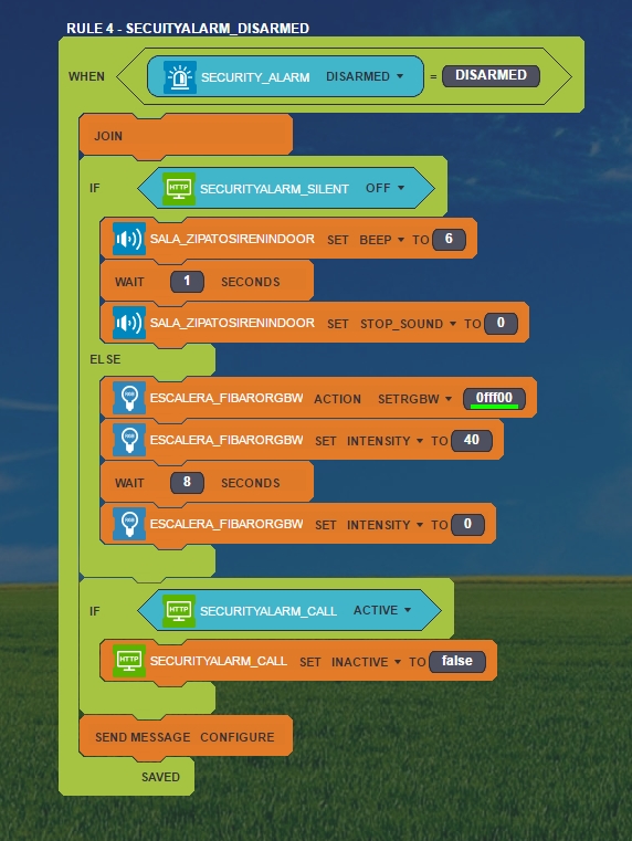

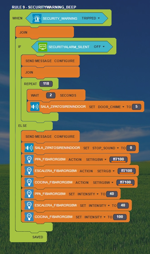

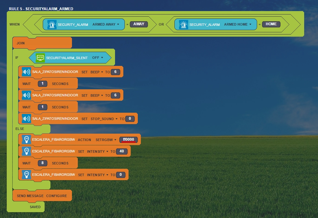

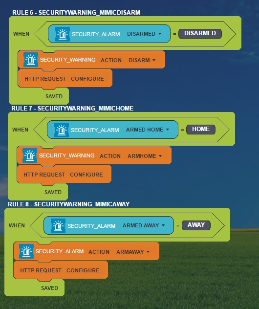

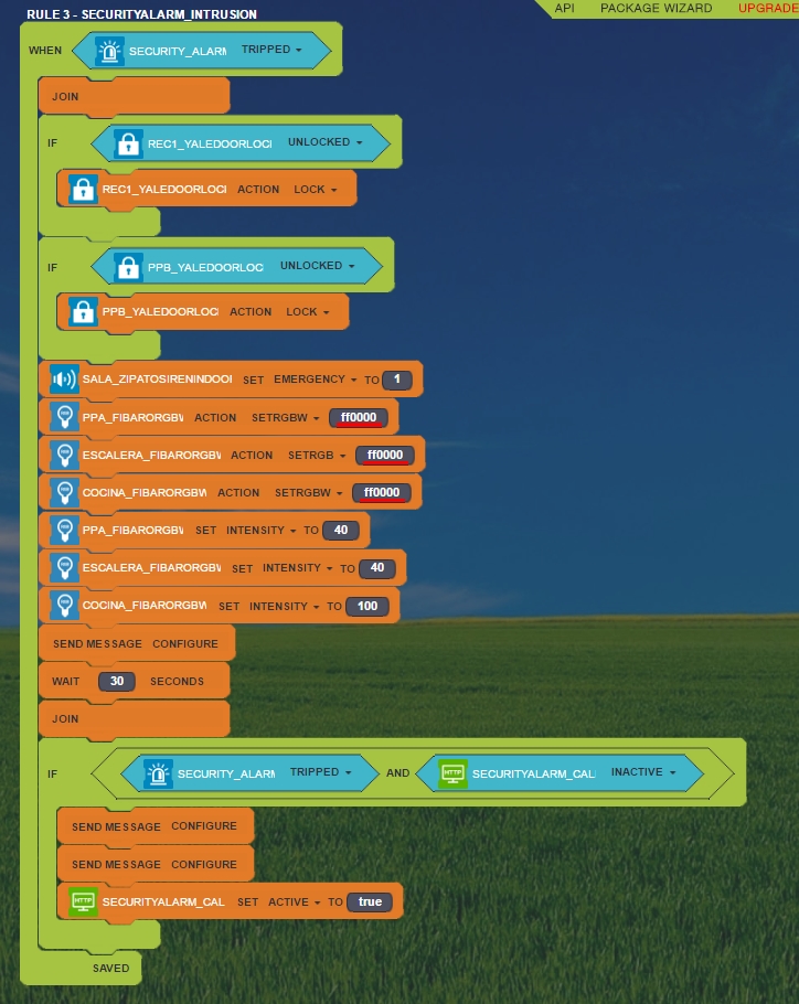

Tim,
No problem, but first I have to explain to you my setup. I have created two virtual alarms with the same zones (Sensors), the first called "Security Alarm" which is my real alarm system, it is tied to my siren and it has configured entry and exit delays. Second virtual alarm called "Security Warning" and it is a silent alarm with no entry or exit delay. The way it works is;
1. I have created rules that "mimic" SECURITY ALARM to SECURITY WARNING (Disarm, Arm Home/Away). Http puzzle I use it to change a value on a virtual meter that I use in Zipatile to also mimic this status (since no cluster stil).
2. I use rules to make siren beep if SECURITY WARNING is breached but SECURITY ALARM is ARMED (Not tripped), I had to implement a rule such as yours in order to stop the beeping if the ALARM is disarmed let's say at second 30. Security Alarm Silent is a virtual switch that I trigger ON/OFF in another rule using SCHEDULERS so if it is late the beeping is replaced by glowing my LED strips green for disarmed and red for armed.
3. I used rules to make siren sound emergency sound if SECURITY ALARM is tripped. See attached and let me know any question or comment.
