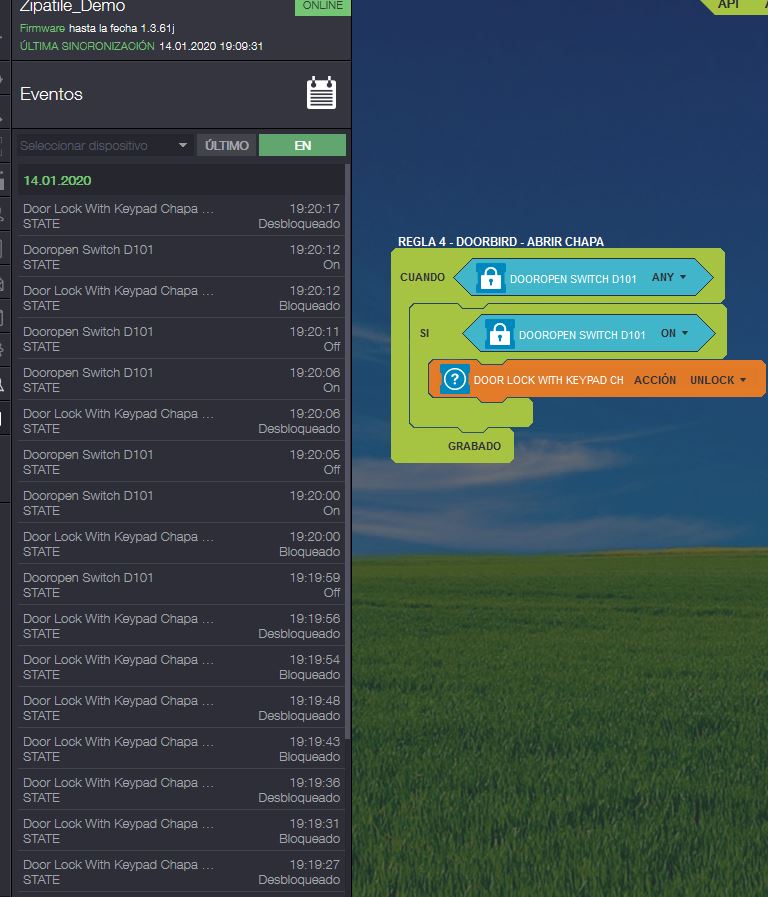

Hi Lars,
Have mine at the office and works without problems, been use in rules as shown in the attachment, I like the new API because now motion its adjusted. even have a rule that turns on the zipatile screen and app.
and another rule to open a zwave lock when pressing from doorbird app.

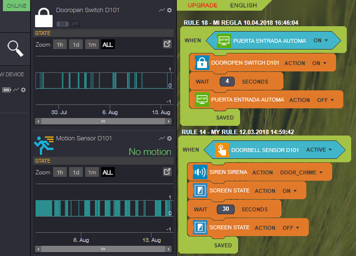

My DoorBirds were working fine and now all of a sudden when I trigger the dooropener over the DoorBird app, the dooropener switches ON and OFF constantly and my locks go crazy opening and closing. I have tried everything and I cant seem to find the issue. Anybody found a way to solve this? This is happening to two of my DoorBirds.
Same problem since last week, I thought it was only mine
My zipabox 2 doesn't find my doorbird as well. Credentials are okay and I also can call the internal website of the doorbird within my network. I have the latest beta on my controller. Any idea?
I have Doorbird DV2101V with Zipatile2 and it does detect my Doorbird device. However It does trigger the relay (ON/OFF) every 5 sec as well.
I noticed from Device Manager, under IP, Doorbird has more than one entries for the DoorBell ON/OFF .. do you have the same for the people who experience the same issue please ?
