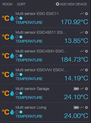

I cannot easily use it in rules, though. Quite often I get too high readings. Like suddenly over 100 deg C in one sample, then back to normal for the next 200 samples.
To add a device you should not have any problems (maybe if you have Zipabox Duo, I will have to investigate that).
You just choose the house number/channel you like. Leave the device in peace for a minute. Start inclusion and press the right button on the behind few times to trigger message sending. Each time the message is sent, the device blinks.
As for crazy readings, I made a kind of fix for that. It might work, but is not yet officially released. If you ask the support for that fix, they might put it on your box. No need to re-add a device.

I need to know what House & channel code is registered to Zipabox as otherwise I do not know where it is located and is it mine or neighbours. That info can be seen at Telldus API, as those are logged also to my Telldus Live but I do not know which I connected to Zipabox.
Also those which I manged to connect to Zipabox are giving strange values, please check the picture attached.
