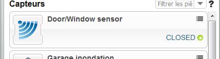

I havesome trouble with my FGK101 sensor. I add it without any problem in my zipabox.
The 3 fonctions are detected :
- Door/window sensor
- External button
- Tamper
I actually use only door sensor, but the thing is that sensor status is not updated (always considered as close).

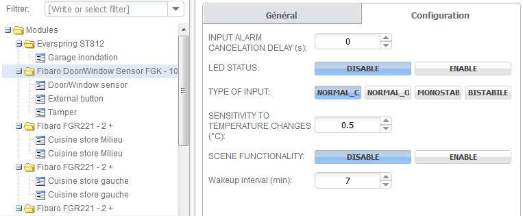

I tried different parameter in input mode but nothing changes.
Am I doing something wrong, is there a compatibility issue with this sensor, or is my sensor not working ?
Thanks for your response.
Stéphane.

I'm not using external swith, I'm using the fibaro magnet given with the sensor.
Since this morning, the sensor status is open, whatever I do. I'm waiting for hours and nothing change.
Likewise, I have sometimes the battery level shown, sometimes not... I'm desperate :'(

I'm not sure if reset is working, but I try it several times with exclusion/inclusion and nothing changes. The module firmware is detected as v2.1 : "Fibaro Door/Window Sensor FGK - 101-107 v2.1".
Yes, I checked it. There is nothing.
I've tried to use GND/IN inputs and there it works! So if I use external door sensor plugged, the sensor state will change in dashboard, if I use magnet it won't.
I'm using sensor's default params.

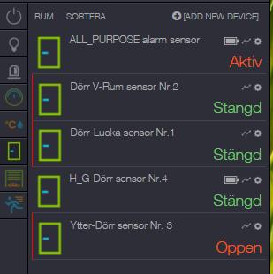

Har samma problem med flera sensorer.
Kan ej change status / kan inte ändra status. Batteri=ok
