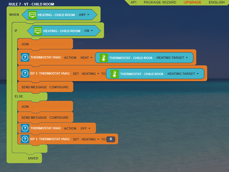

My guess is that currently this valves are not fully supported on our Zipato systems. I tried to create a rule (see attachment), but I had partial results:
- Virtual Thermostat Pro is switching off Fibaro Heat Valve
- Set point does not work properly. I had tried several rule configurations but with unsuccessful results :(
