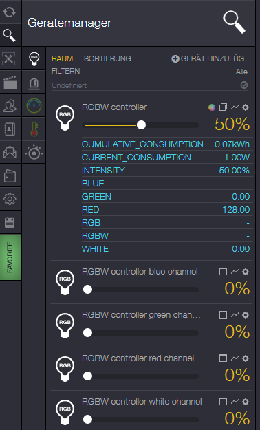

Fibaro RGBW Controller, wrong channels values shown
When i set the Value for one single channel of the RGBW Controller with a rule, then the value for this channel is false within the device manager. For example the value of red channel is set to 50%, but it shows 0% for this channel. If i look into the RGBW Controller the shown value is shown correct.
