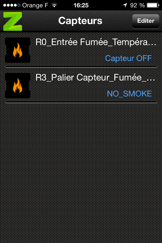

I bought 2 Fibaro Smoke sensors and I face various and random problems to set them up.
One is I do not have the same states on my Iphone, while the setting is absolutely identical (see picture 1) : one is "NO_SMOKE" and the other one is "Capteur OFF".

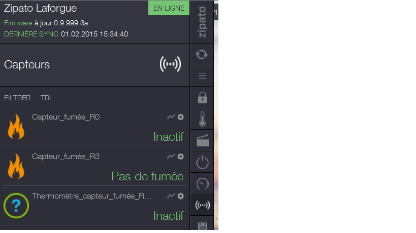

On my.zipato, it is different : I have "Pas de fumée" and "Inactif". The problem is similar, since I have them translated. But I have also another problem on my.zipato : the temperatur captor of one of the smoke detector appears as a captor and not in the "measures" section (see picture 2).
I do not have this problem on my Iphone ( temperatur measured by this captor is at the right place).
While I was setting up the data, I also had troubles changing the type of device. If I change " Fire captor" with "Temperature measure" and save, my change is not saved... but the icons change on the Iphone (sometimes). Very weird.
