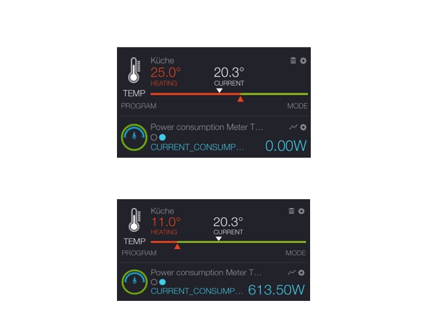

can anyone help me please with my thermostat topic. Something is totally in the opposite way.
Heater: 230V/600Watt Infrared heater
Thermostat: Qubino Flush On/Off thermostat (ZMNHIA2)
Scenario1
Room: 20.3°C
Setpoint: 25.0°C
-> Heater switched OFF (0.0Watt and no 0V outlet measured)
Szenario2
Room: 20.3°C
Setpoint: 11.0°C
-> Heater switched ON (613,5 Watt and 230V outlet measured)
Thanks for your help.

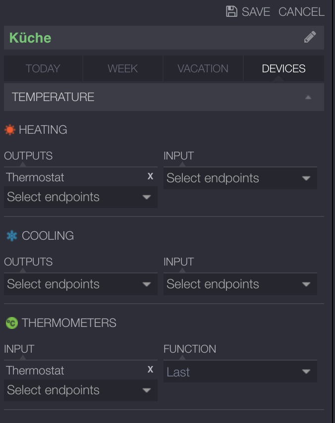

I had same problem. Change relay switch selection to NC (Normaly Close). There are a problem with hysteresis on and off. It should be
0-127 = 0 - 12,7°C it´s ok in zipabox
128-255 = -0,1 - -12,7°C but in zipabox it is 128 = -12,8°C and 255 = -1°C
For me it works with settings in picture.
