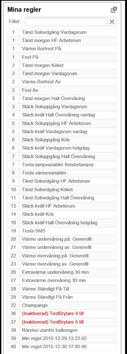

This is an example of problems after when you uses the old rule creator.
Duplicated rule numbers and total disorder.
Before all rules was in alphabetic order.
