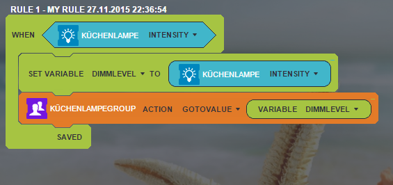

create a group of lights: ea. kitchen
Decide a dimmer that you hopefully have, to be the master controller for the rest of the lights. Like I have done with the lights in the living room(Qubino dimmer).
Create a rule with the dimmer that change value of a variable. You can cal the variable what ever you want.
Let this Variable control the group of lights. Something like this:

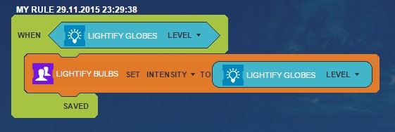

thanks for your reply. That sounds really good. I tried to rebuild it. Unfortunately, it doesnt work :-/
Below my latest rule. I tried hundreds of variations. There must be one error in it that I cant find. Any idea?
Thanks a lot!
Thanks a lot!
Can you trie any other lights?
Have you synced both on right and left side of the web interface?
And what type of divice is your dimmer?
hahaha - I cant believe it. Spend hours on that little thing in the last days and basically just didnt know that I have to synchonize both sides of the web interface XD
THANK YOU so much!!! It does work now.
