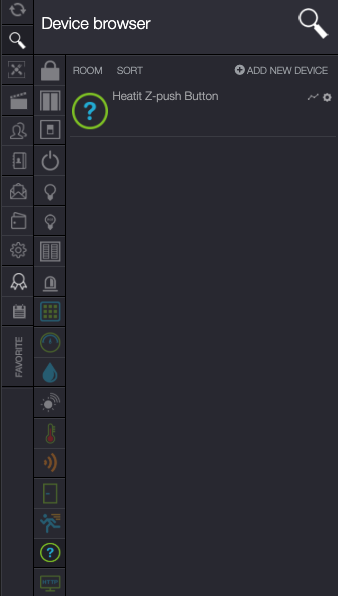

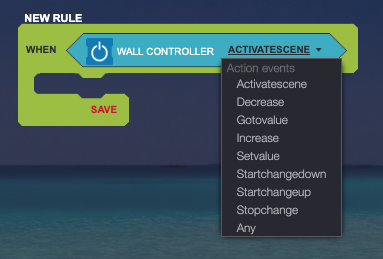

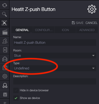

Zipato cannot determine what type of device this is (see attached 1). Also, and maybe therefor, the device don´t show up with any functionality for configuring the different buttons (see attached 2 and 3). This means I can´t trigger a specific scene, as I can´t tell the system which of the eight buttons that shall trigger the scene.

  • The device does not support any direct button push through the Zipato web interface or the app. Only physical touch on the buttons. Hence it does not show by default up as a device under Device browser. Only its endpoint shows up under devices in the rule creator.

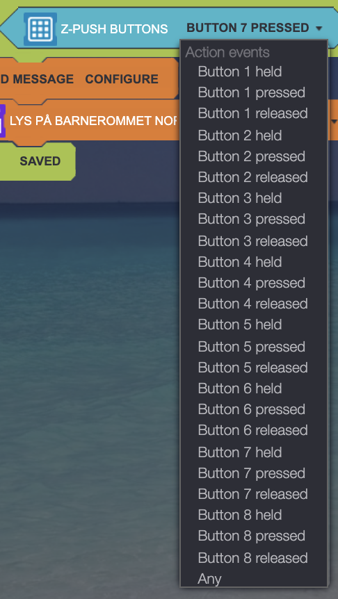

  • Each button can distinguish between press, hold and release. (I have not tried the release function tough.) This means that you can actually control/trigger 8x3=24 different actions. After Zipato did the update, the action options now looks at attached.
