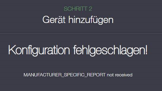

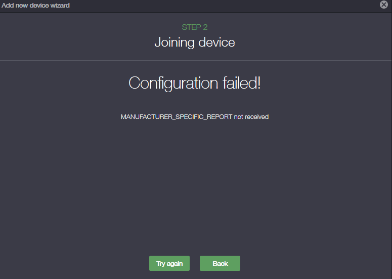

I have the problem does the Heiman smoke detekor wont be included. The inclusion procedure aborts by it self. And if it works it wont be displayed in the device manager.
Also reseting the device will bring success in the further inclusion.
Configuration failed!

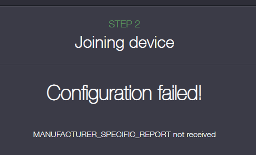

Same Probleme with Heimann smoke detektor.

Yes, including this is pain in the a... Button below sensor near battery is not correct. Net button is in the middle and reachable only by included wire.
Then when including you get timeout,since zipaboxis too slow. You need to press NET button every 10 seconds to wake up sensor. Do that until you get rename sensor.
Hi Metod,
Indeed that was the trick!
The sensor has been included now.
Many thanks!
Hi Metod,
Many thanks!

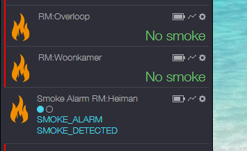

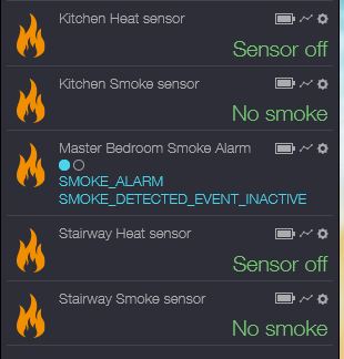

Is this the normal way the detector is displayed?
it is different from my other detectors
Hi Lars,
I have the same and indeed different compare to Fibaro smoke sensor.
Also this Heiman has unfortunately no temperature readout
Hi Lars,
