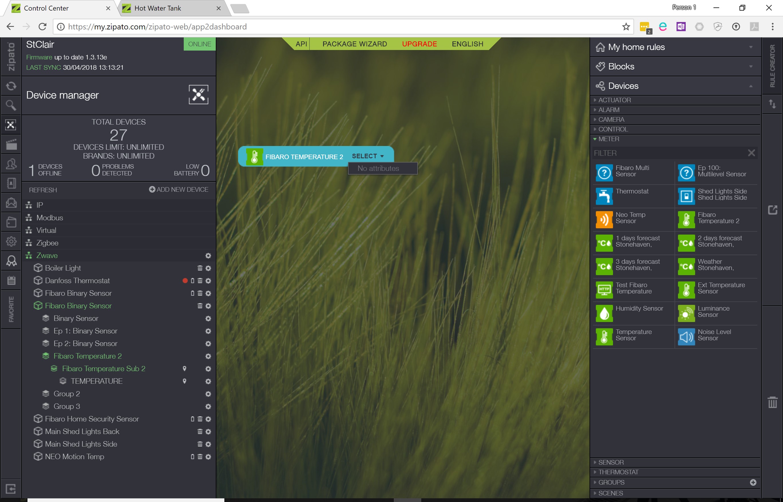

To the rules creator...I'm sure you can get the temperature from the fibaro's in the rule Controller. Maybe also post a Screen shot of the rule and how you try to check the temperature.
Just a little hint. You Need to use the measure device (not the sensor) in your rule (sorry I use the german version). See attached pic to see what I mean.

Here is the screen shot of the rule creator. I will put it into a When rule once I get attributes to work.
Hi Graeme
did you try to mark one level above and top level as device?
Beat
Do you get readings at all? As far as i know the universal sensor is not compatible with digital but with analog sensors
Yes the values show up in the Device browser. The fibaro Universal sensor is compatible with up to 4 DS18B20 sensors.
