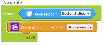

You need to create a rule for that. See example in attachment.
OK, thank for the rule, i do it but how to associate to the keyfob ?
What do you mean by "associate"?
I think the example is clear, when you press button on keyfob some actions are going to be executed (run scene in example).
Yes, the example is clear, i do that to run a scene (the scene run well with the dasboard), but i press button it doesn't work. Why? what can i verify to known if the keyfob is ok, On the dashboard the device is active, the endpoint is active, but the ihm bindings is empty
