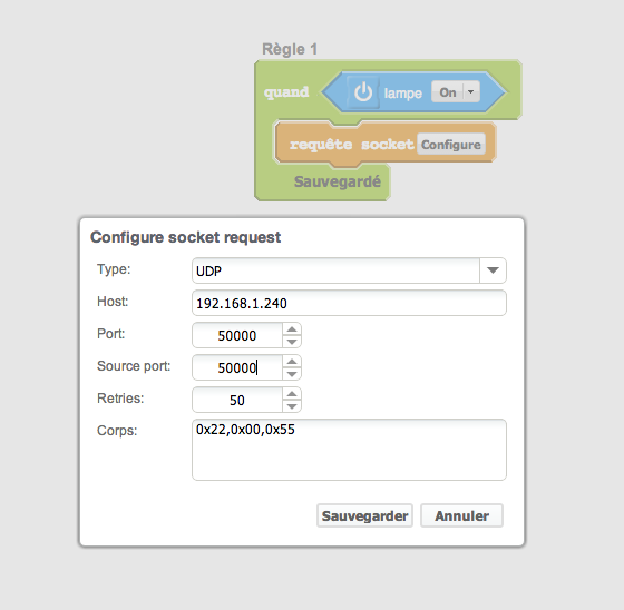

I need your help to control MiLight/Easybulb/LimitlessLED with my Zipabox. Sorry in advance for my bad english.
I have one RGB and 1 white bulb. The wifibox used my home network and works well with the original Android App.
I would like to control it with the UDP socket option on my Zipabox .
Here is the request with a Vera :
socket = require("socket")local s = socket.udp()s:sendto(string.char(0x22,0x00,0x55), "192.168.1.240", 50000)s:close()
http://forum.micasaverde.com/index.php/topic,14471.0.html
As you seen on the picture, I have configure socket request like this :Type : UDPHost : 192.168.1.240 Port : 50000 Source Port : 50000 Retries : 50 Corps : 0x22,0x00,0x55 And I have created a rule "when I put the switch "lamp" On, send this UDP socket.But it does not work... Thank you for your help.

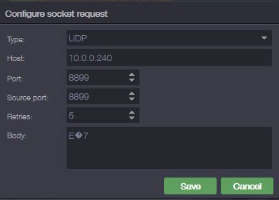

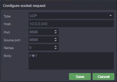

I can control my milight via zipato now (thanks to Robert Salomons!)
Codes for the milight:
http://www.limitlessled.com/dev/
Ive read the codes from the manual and converted it to ascii via the website http://www.asciitohex.com/
For example, Group1 All Off
Decimal: 70 00 55 -> convert
Ascii: F�7 -> copy
I use this as body message in a rule (see attachments)
Then ive created a virtual switch and a rule for "on/off"
This is working for my milight bulbs.
Edit: ok i have to use more retries to get all of my 3 Bulbs in Group1 off/on - ive set it to 50.
