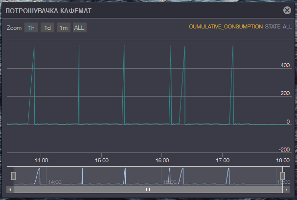

How cumulative consumption can go up and down?
I think, that cumulative can be only increasing number, until it will get reset.

I too have the same issue. CUMULATIVE_CONSUMPTION is going up and down, and the CURRENT_CONSUMPTION never shows.

After last firmware update my only one correctly functioned Aeon smart switch lost its capability to show cumulative consumption steady raising, as it should be. Now it is bouncing up and down between zero and something, which is about 5 times more, than real.

Now i see. Its because Zipabox shows current consumption as cumulative consumption. Thats why.

Yes, seems like the two values are swapped!
