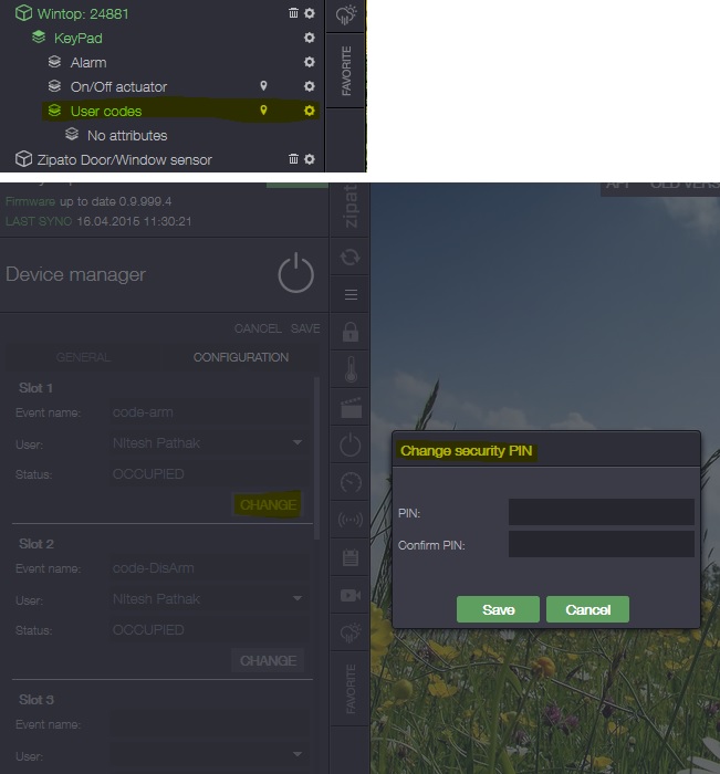

Hi Marcus, I am not able to see "Learn" under configuration. Infact "keypad" child object doesnot have nay configuration tab.. it further has some child objects out of which one is "UserCodes". This one has the configuration tab and available slots. I used this to set up the "Pin" for arming and disarming. But there is no "Learn" mode. Please see attached image.

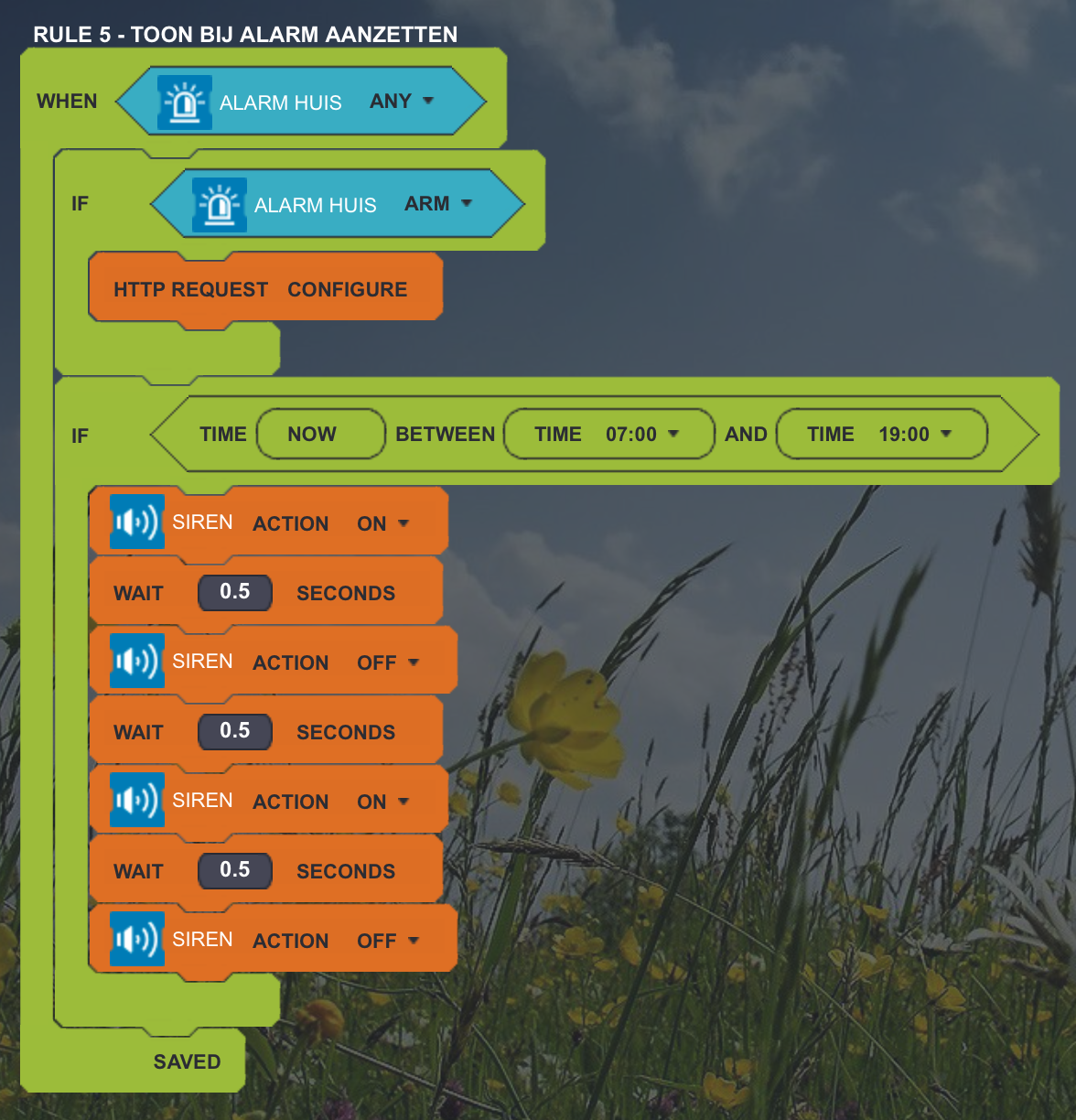

I created this rule (see attachment) to know my alarm is on or off. Works great and does not wake up the kids outside of the hours in the rule :) By the way, I also use the keypad with RFID for me and my wife (we both have an RFID). See this youtube clip I created yesterday: https://www.youtube.com/watch?v=Pmc7t5j53sg
