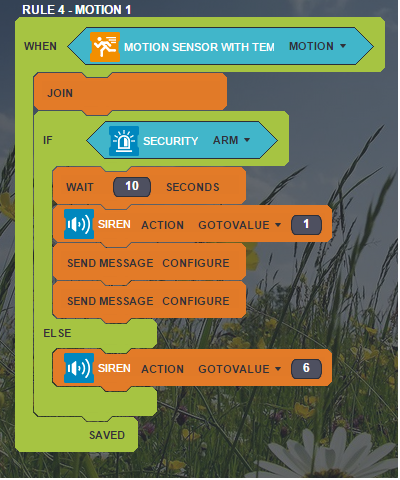

I Also have problems understanding the join/stop commands, in the example above : will the light be on (i.e 10 mins) until i click the button again and then it would go out after 30 sec. ?

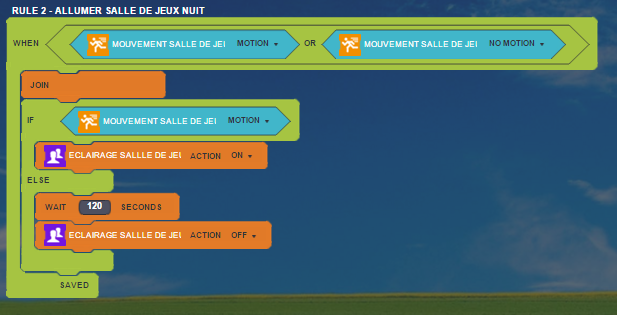

Took me a little while to understand the behavior of 'join': so this is how I understand it: Join will stop all 'previous' execution of the rule. So if there is a wait in the rule, a second parallel execution of the rule can occur. When the second rule hits 'join', the previous execution of the rule is stopped.
For instance the rule below will turn light off 120 seconds after sensor is in no motion, unless the rule is trigerred by motion again.
