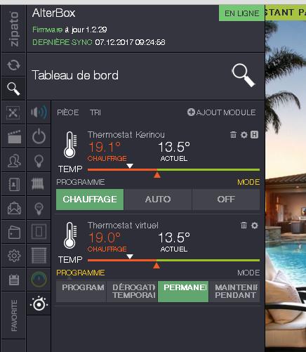

Does anyone still have this problem? For me nothing worked to change the thermostat heatpoint.
Thermostat Configurations: Real Virtual , Input to real , Output to virtual .... seems correct
But what about the Settings :
button Mode have 3 choices: Heating / Auto / Off
button Configuration have 4 choices Programm/Derogation/Permanent/Maintenir pendant ...
I can't find any users manual about those choices combinations
Olivier
Olivier
