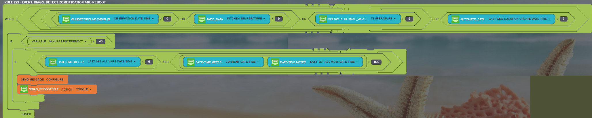

Now for the detection of zombification. Since I want to detect when my variable-setting rules are not working, I save a time stamp each time those rules run (see my date-time meter post on creating time stamps). Then I create another rule that detects when that time stamp is out of date. Since my external data sources are still updating even when the box is not responding properly, I can create a rule that reacts to changes in those data sources, have the rule check the time stamp, and if the time stamp is old, reboot the box. See attachment.
The rule checks a selection of external data sources to ensure that it gets called pretty frequently. I disable the check immediately after a reboot because the system takes a while to get itself together.

This is the rule that calls the app script. The GaS must be made accessible to anyone, even anonymous (I think). Otherwise you can't invoke it from outside.
