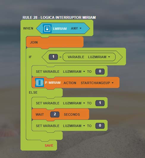

Here is an example. If the switch of light is changed twice quickly (into 2 seconds)... the roller shutter will go up.
In order to do that, I have used a variable: That variable is set to 1 only 2 seconds after the first time, In that case, if the swich is pushed again, you can execute other action.
