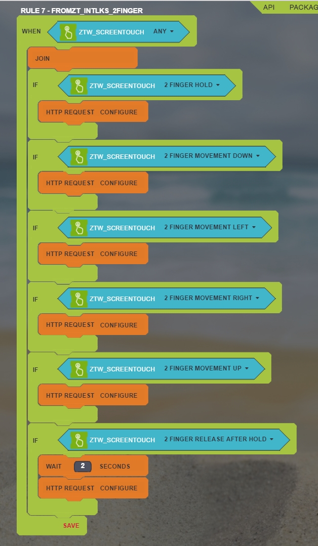

This is how I send ZT touch control commands to my zipabox as of right now.

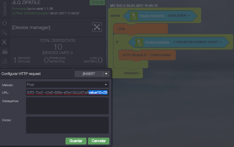

No problem, first go to your zipabox and create a virtual meter, this device will add you one device with several meters, you can name one for example "ZipatileInterlocks" on device manager, also while you are there copy it's URL from the settings screen, you can test modifying its value pasting that link into your web browser and at the end adding a numeric value, for example 5, should look something like this;
https://my.zipato.com/zipato-web/remoting/attribute/set?serial=YOURBOXSERIAL&apiKey=YOURDEVICEAPIKEY&value12=5

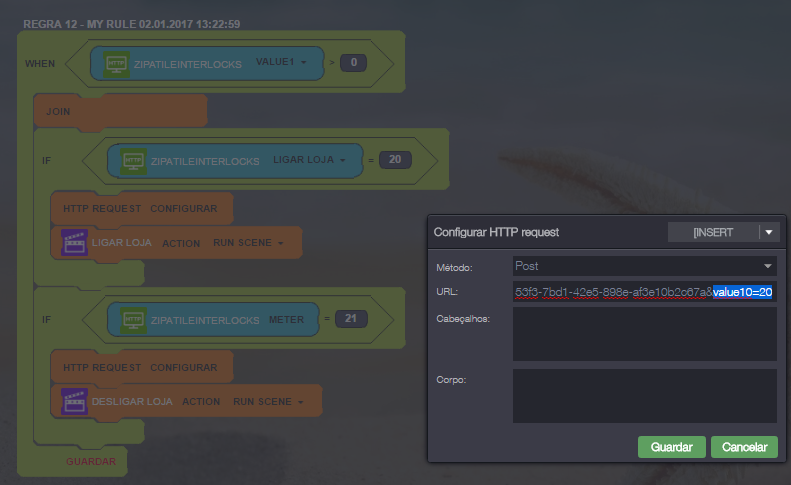

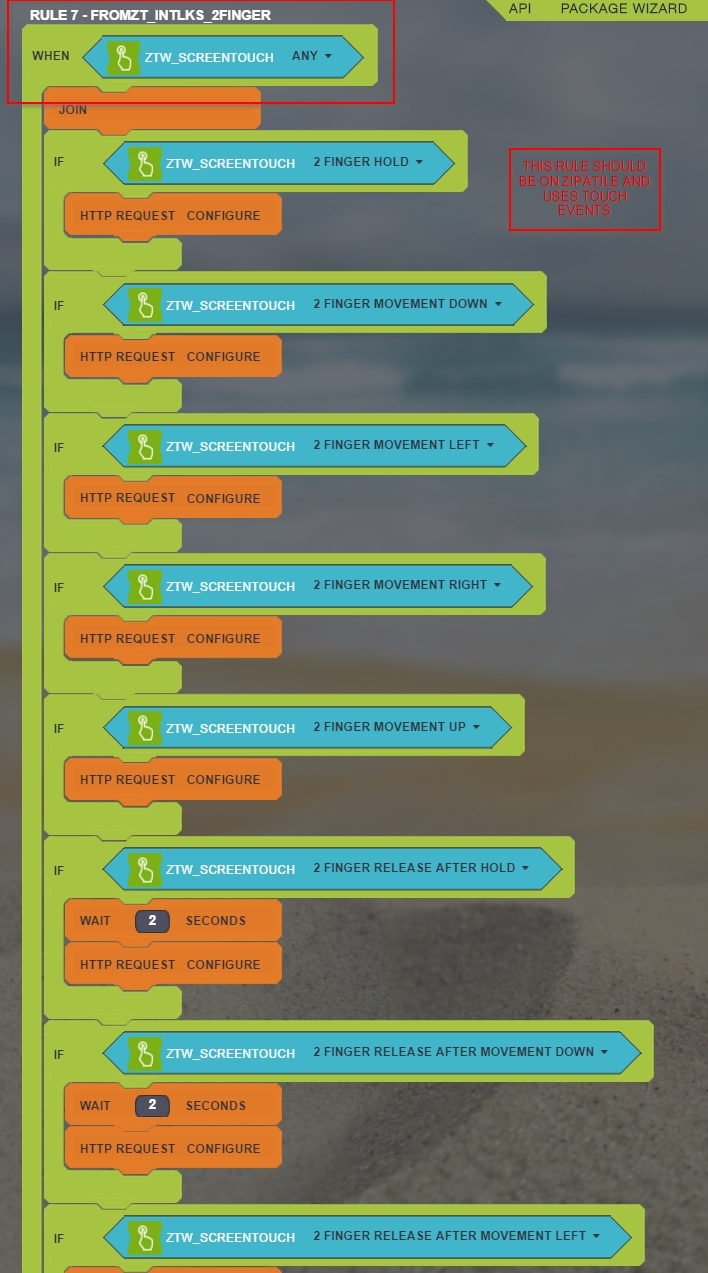

Now go to your zipatile and create a rule like the one attached, configuring the desired events to some numeric values, example 1=1 finger touch, 2=2 finger touch, etc. Use POST HTTP request puzzles to change the meter to the desired value based on the event. See rule "R1".

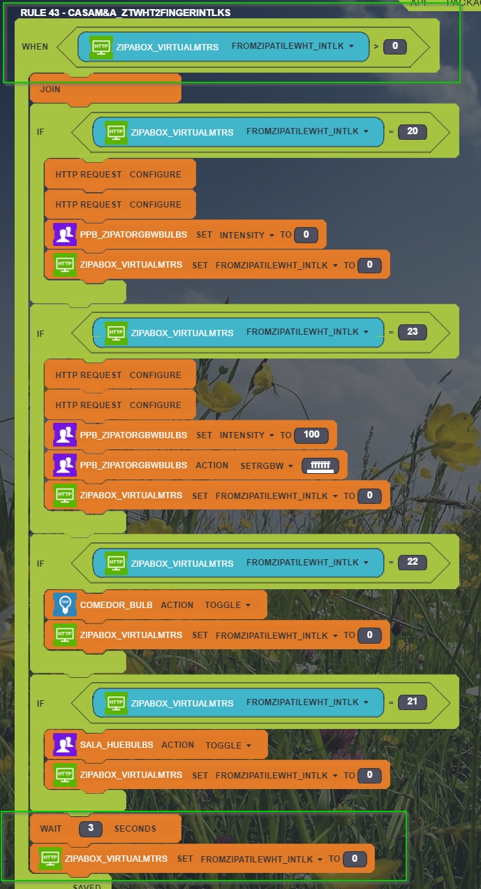

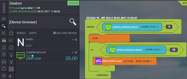

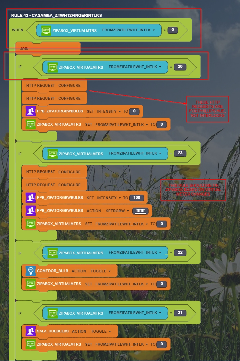

Now go to your zipabox and create a new rule, should look something like attached example "R2". Basically whenever the virtual meter's value is greater than 0 this rule will be run, then using IF commands you can compare if it's equal to 1, 2, etc. Do something within the IF statement and then set the meter to 0 again.
