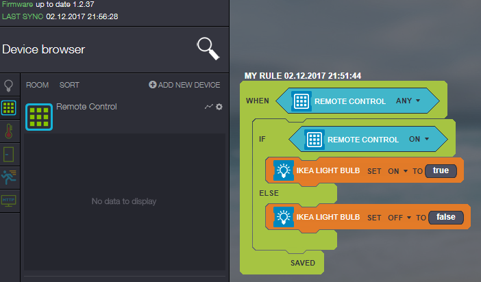

Hi forum!
I have managed to get my IKEA remote to pair with my Zipabox (YEAH!), but cannot get it integrated in a rule. Also, it does not show any data on the graph. Could someone point out what the issue is in the attached picture?
The IKEA light bulb functions flawlessly in another rule (YEAH!) were it turns on and off so I guess that part is ok.

I would like to check your isuse with the remote and the sensor if you send me your zipabox SN at zcerovski@3plus.hr. Also, I might need your assistance so it would be good if you are available for skype chat tomorrow.

Željko from Zipato could unfortunately not get contact to the Zigbee module from the IKEA remote and motion sensors. Too bad. It could have been a great advantage to use the IKEA motion sensors and buttons. But thanks to Zipato for making the attempt. :-)
