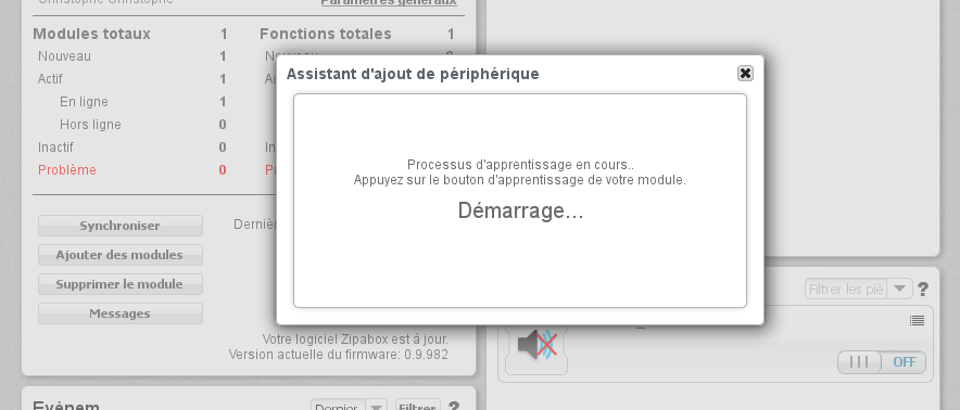

i still can't include fibaro fgk101 on my zipabox. I've 2 of them and each don't work.
I've made all tasks required (desassociated, factory reset module, 3 fast click on tmp button, check length from box, check battery...), it's NOT working !
Sometimes, the web screen is blocked on the "start popup" see attach file.
I've read to many posts about this bug. It seems zipato don't mind and fuck this module.
