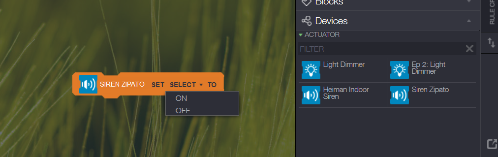

There is no option in the rule creater.

In the rule craeter you can choise the kind of signal you want to hear. Thats works for all of the other sirens.
So explaime me how i can send a door bell signal? (it´s not possible)
The device is not fully implemted. But i need the door bell funktion for my customer.

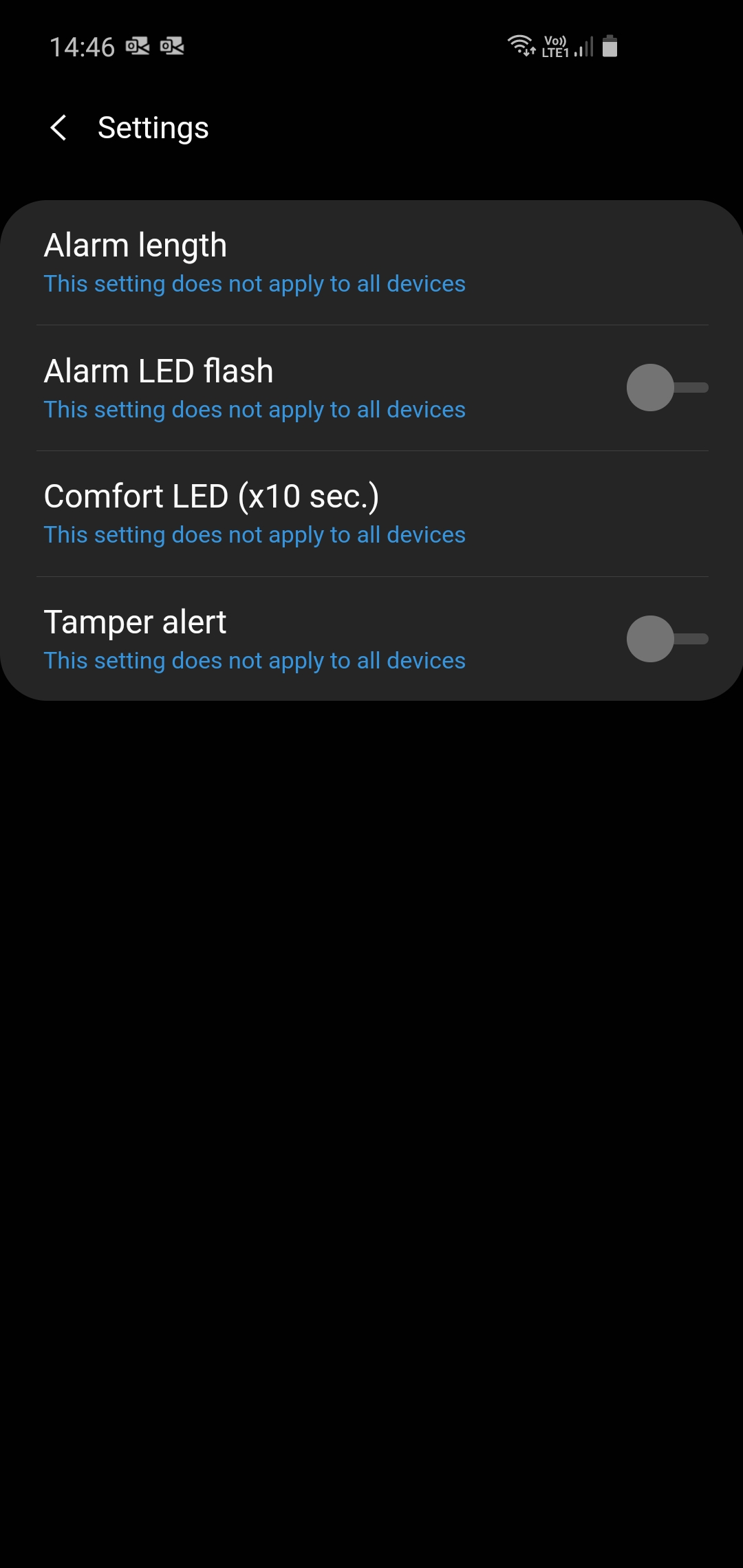

Does anybody know how I can configure different sounds when it is used with Smartthings Hub ?
you can change configuration parameter 5 and set its sound. Please refer to its manual.
Hi brian i think there are two Problems. First you have to choise which Type of Sound Do you want one for Alarm and one for doorbell. That is fixed then. Not realy brillant. Second: you can not select Alarm or doorbell in the rule creater. In other words it is Bull#######
Hello Dino, I've been through the manual but the configuration options do not seem to be available through the Smartthings App.

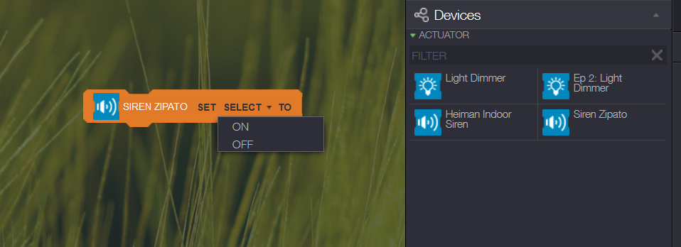

I can turn it off or on (strobe & siren) the only settings are shown in the attached screenshot
Hi dino please read my post again. There is noch Problem to Set a noise Typ. But There is a Problem to select it in the rule creater. Have you unterstand this?

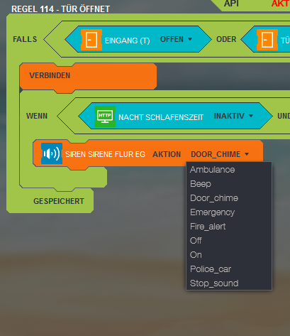

I have two Zipato indoor sirens, and I have the possibility to select the different sounds in the rule creator. It seems that the discriptor is damaged.

there are two types of Zipato Indoor siren:
1. PH-PSE02 (https://www.zipato.com/how-it-works/supported-devices?modelId=795&manufacturers=zipato) - it has multisound settings in its descriptor so it is possible to use sound types in the rule creator
2. NE_NAS-AB02Z (https://www.zipato.com/how-it-works/supported-devices?modelId=577&manufacturers=zipato) - it has multisound settings in its configuratino parameters so it is not possible to use sound types in the rule creator
